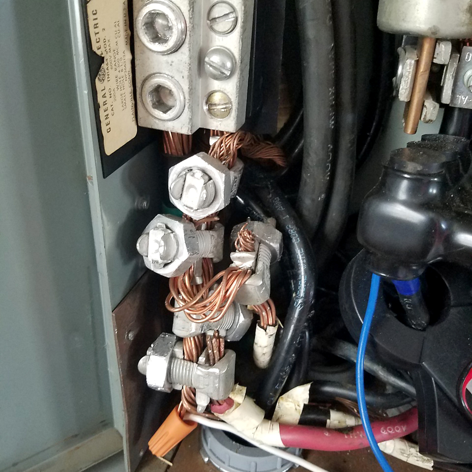

What’s Wrong Here? Hint: Naughty neutral connections
How well do you know the Code? Think you can spot violations the original installer either ignored or couldn’t identify? Here’s your chance to moonlight as an electrical inspector and second-guess someone else’s work from the safety of your living room or office. Can you identify the specific Code violation(s) in this photo? Note: Submitted comments must include specific references from the 2020 NEC.

Our three winners this month were: Scott Burti, president of Burti Electrical Services LLC in Old Forge, Pa.; James Hoover of Hoover Technology Solutions in Martinsburg, Pa.; and Michael French, an EC&M reader from Lynn, Mass. They all knew that this is an unacceptable location for these service conductors.
Section 230.9(A) requires service conductors or service cables without an overall outer jacket to maintain a clearance of not less than 3 ft from windows that can be opened, porches, balconies, stairs, ladders, fire escapes, and other locations like these. For vertical clearances of final spans above or within 3 ft horizontally of platforms or other surfaces that permit personal contact such as this porch, Sec. 230.9(B) requires the rules of Sec. 230.24(B) be followed. The vertical clearance from the porch to the lowest point of the drip loop is required to be 10 ft minimum as specified in Sec. 230.24(B)(1). Section 230.26 requires the point of attachment to follow the same requirements specified in 230.24. The point of attachment needs to be located at least 10 ft above the porch level. Perhaps it would have been better if the installer chose an installation location farther away from this porch.
