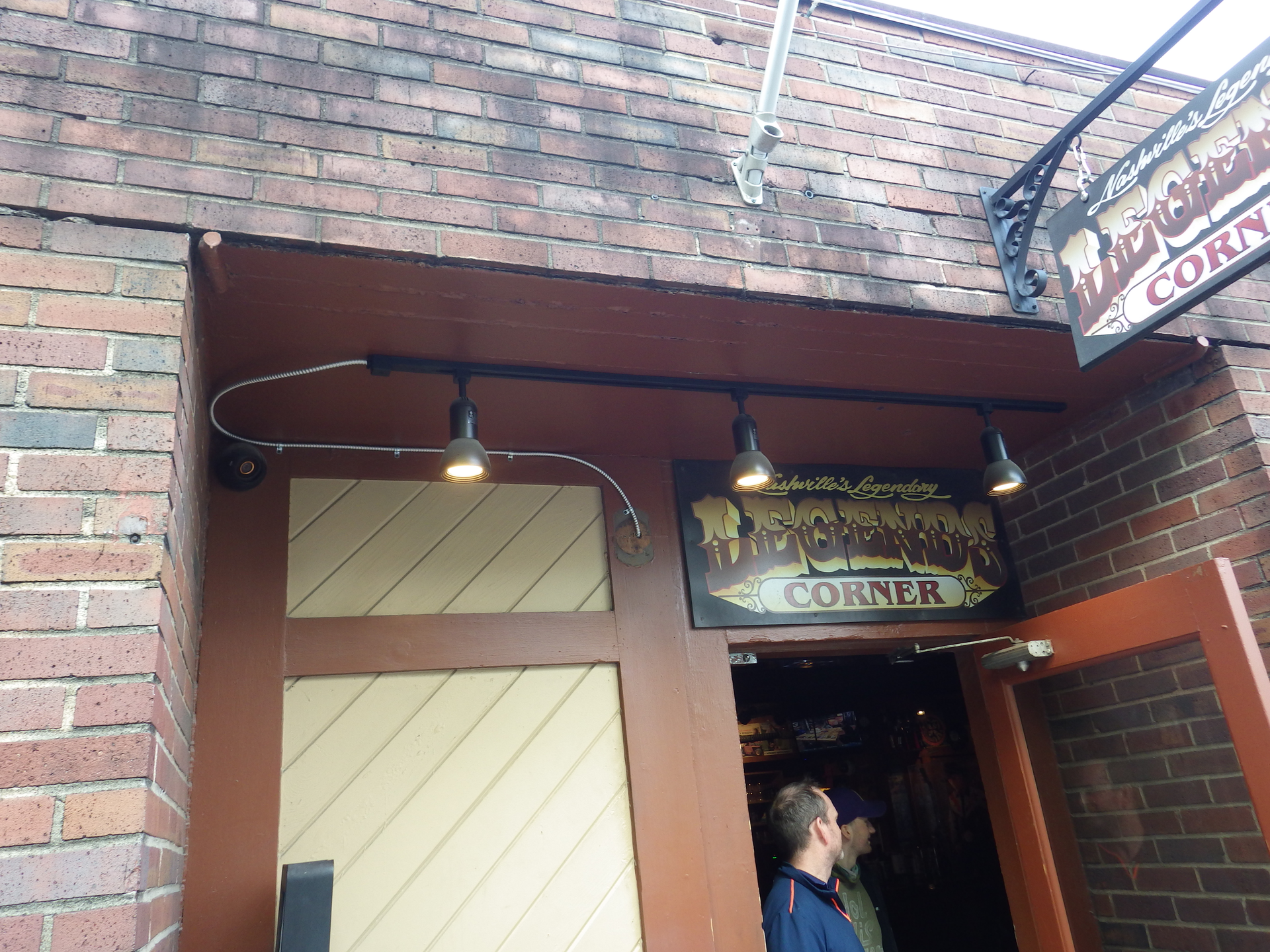

What’s Wrong Here? Hint: Dampens My Spirits
Hint: This installation dampens my spirit.
We can debate whether the location where the lighting track and MC cable is installed is considered either a wet location or a damp location per Art. 100 definitions, but this is certainly not a dry location. In any case, the wiring and equipment must always be suitable for the location. Section 410.151(C)(2) strictly prohibits lighting track from being installed in damp or wet locations. For MC cable installed in wet locations, Sec. 330.10(A)(11) requires a corrosion-resistant jacket to be provided over the metallic covering and the metallic covering must be impervious to moisture. Additionally, a moisture-resistant jacket must be provided under the metal covering. Lastly, the insulated conductors under the metal covering are listed for use in wet locations. This MC cable does not appear to comply with those requirements.
