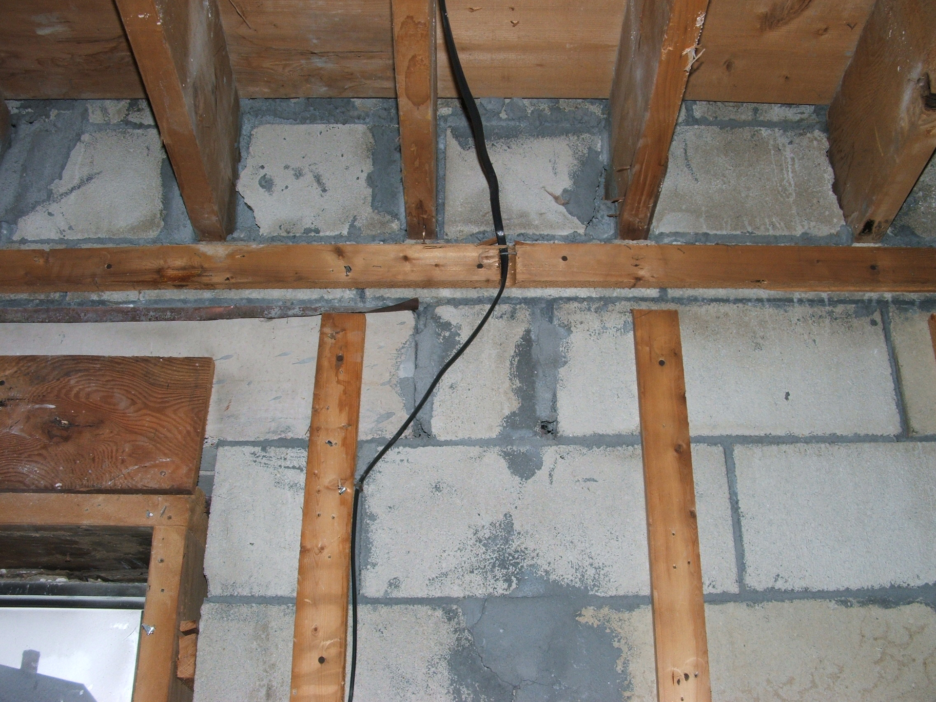

What’s Wrong Here? Hint: Waiting for the drywall installers
How well do you know the Code? Think you can spot violations the original installer either ignored or couldn’t identify? Here’s your chance to moonlight as an electrical inspector and second-guess someone else’s work from the safety of your living room or office. Can you identify the specific Code violation(s) in this photo? Note: Submitted comments must include specific references from the 2020 NEC.

Congratulations to our three July winners: Ted Fritz of Fritz ElectRick in Byron, Ill.; John Lanzillo, an electrician in Marshfield, Mass.; and Justin Thomas with Spaulding Hospital in Chelmsford, Mass. Also, a big “thank you” to Robert Atwood, supervising electrician for Hollywood Lights, Inc., of Portland, Ore., for sharing this photo with us. “The owner stated that although it had been this way for many years, it didn't seem to be a problem until their grandkids started spending time with them,” says Atwood. “That’s when they decided it was a good idea to move it to a better location.”
Section 680.72 requires hydromassage bathtub areas to comply with the general rules for bathrooms. Section 240.24(E) prohibits overcurrent devices from being installed in bathrooms of dwelling units, dormitory units, and guest rooms or guest suites. Section 240.24(A) requires overcurrent devices to be located in a readily accessible area without needing to climb over obstacles. Section 110.26 requires unobstructed and clear working space in front of this panelboard. For panelboards in damp locations, Sec. 408.37 refers to Sec. 312.2, which requires enclosures to be placed or equipped to prevent moisture or water from entering the enclosure.“Tell Them What They’ve Won...”
