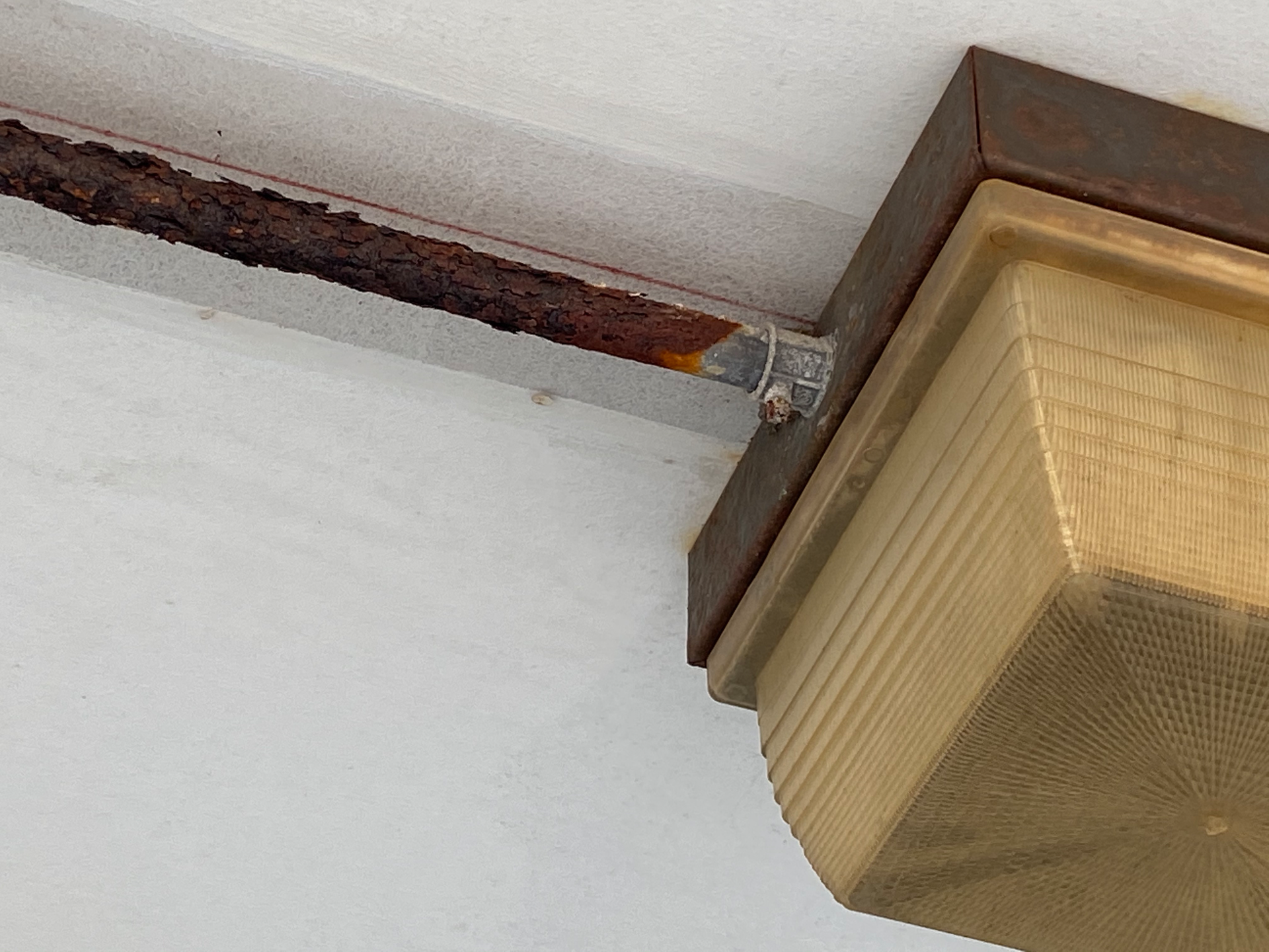

What’s Wrong Here? Hint: Beachside Bungle
Hint: Beachside bungle
I spotted this rusted and rotted electrical metallic tubing (EMT) on a recent visit to the beach. Long term exposure to the salty air in this oceanside community has taken its toll on this raceway. Section 300.6 requires raceways, fittings, couplings, supports, and support hardware to be made of materials suitable for the environment in which they are installed. Perhaps the use of a nonmetallic wiring method would have been a better option here. I did notice other installations made with PVC conduit in this same area which seemed to be holding up to the environmental conditions perfectly fine. Of course, stainless steel conduits and hardware may be another viable option here too. The entire run of EMT feeding several lights installed under this roof overhang was completely rusted as shown in this picture. It is probably time for this installation to be ripped out and replaced. The corrosion will only continue to get worse.
