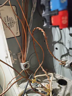

What’s Wrong Here? Hint: A maintenance guy’s mess
How well do you know the Code? Think you can spot violations the original installer either ignored or couldn’t identify? Here’s your chance to moonlight as an electrical inspector and second-guess someone else’s work from the safety of your living room or office. Can you identify the specific Code violation(s) in this photo? Note: Submitted comments must include specific references from the 2020 NEC.
August Winner
Congratulations to our lone winner this month: Jason Snyder of Laser Electric, Inc., in Peoria, Ill. He identified several Code violations in this photo. I’d also like to thank the apprentice electrician who initially shared this photo with us, but wishes to remain anonymous.
Section 408.40 requires a terminal bar to be connected to the metal panelboard enclosure for connecting all the separate equipment grounding conductors. Section 110.12(A) requires the unused opening in the bottom of the cabinet to be closed in a manner that provides protection equivalent to the cabinet walls. Stuffing multiple wires in a terminal designed for only one conductor is a violation of Sec. 110.14(A) and Sec. 110.3(B). Intermixing copper and aluminum wires in the same terminal is a violation of Sec. 110.14. You may also notice the larger foot lug is missing the set-screw connector needed to secure the wires. Loose equipment grounding and bonding conductors could create a high-impedance path for fault current and would violate the requirements of Sec. 250.4(A)(5). Loose connections can also result in dangerous arcing and sparking, which could eventually lead to a fire or worse.
