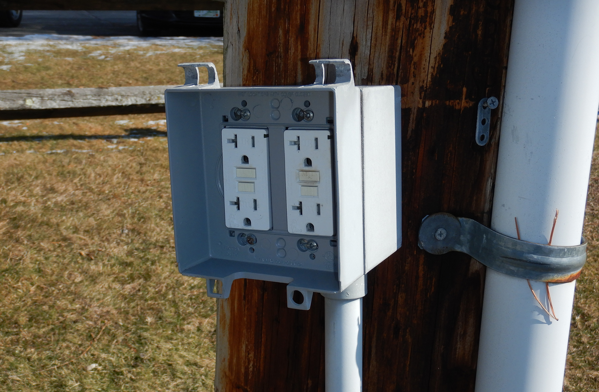

How well do you know the Code? Think you can spot violations the original installer either ignored or couldn’t identify? Here’s your chance to moonlight as an electrical inspector and second-guess someone else’s work from the safety of your living room or office. Can you identify the specific Code violation(s) in this photo? Note: Submitted comments must include specific references from the 2020 NEC.
Hint: This burst my "bubble."
November Winner
Our lone winner this month was Jennifer E. Kuether, P.E., and chief electrical engineer for Epstein in Chicago. She was able to point out some of the problems with this installation.
The cartoon mascots for Rice Krispies cereal would probably be impressed by the snap, crackle, and pop that this PVC raceway must have made when it broke apart. Perhaps installing a PVC conduit expansion fitting or using a flexible wiring method would have been a better option for protecting these service entrance conductors.
Section 230.43(15) does provide limited use of liquidtight flexible metal conduit (LFMC) for wiring of service entrance conductors. For services, LFMC is limited to a maximum length of 6 ft, and a supply-side bonding jumper must be routed with the LFMC.
Thermal expansion may have also played a role in the destruction of this raceway. Section 352.44 requires expansion fittings to be installed in the PVC conduit run where the length change is expected to be ¼ in. or greater “in a straight run between securely mounted items such as boxes, cabinets, elbows, or other conduit terminations.”
In any case, this service needs to be rewired.
