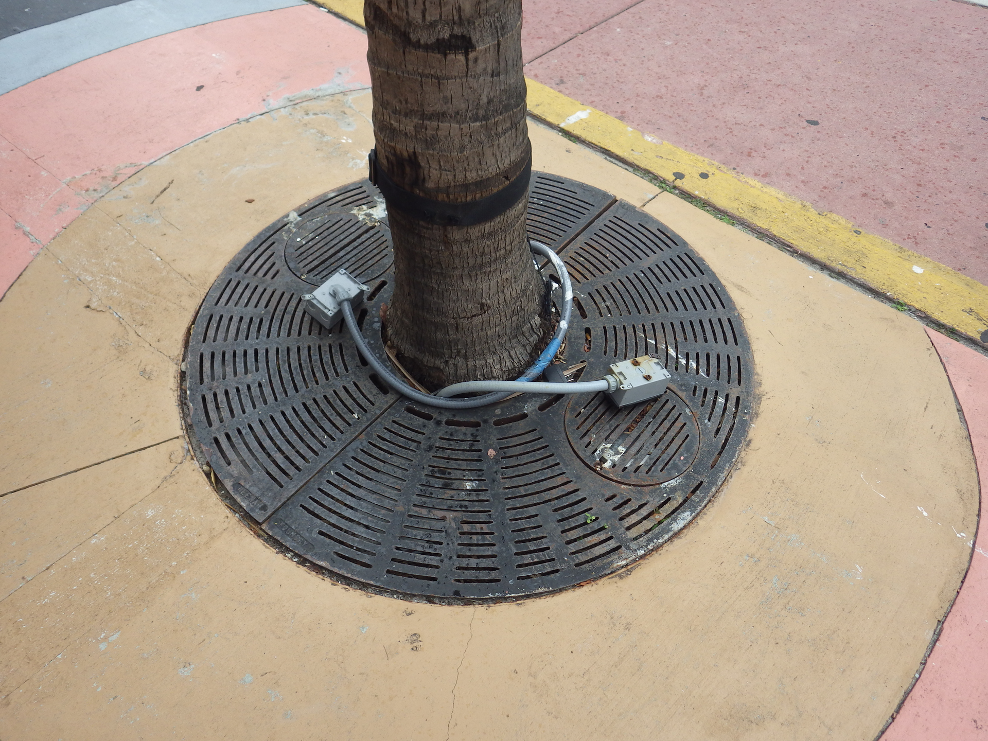

I spotted this installation while on vacation in a southeastern state. Those boxes installed on the end of the liquidtight flexible nonmetallic conduit (LFNC) contain receptacles. I am speculating these boxes were once secured to this tree, but I cannot be 100% sure that’s true. Using trees to support this type of wiring and equipment is not specifically prohibited by the Code. In fact, Sec. 410.36(G) specifically permits using trees to support outdoor luminaires and associated equipment. Section 230.10 does prohibit using trees to support service equipment or overhead service conductors. The installation as I found it violates the requirements in Sec. 314.23 for securing and supporting boxes. One or more of the support methods specified in Secs. 314.23(A) through (H) shall be used. None of those methods were used here. The LFNC is certainly subject to physical damage and should probably not be used as it is prohibited by Sec. 356.12(1). The LFNC may not comply with the securing and supporting requirements described in Sec. 356.30 either. Lastly, the type of receptacle covers used on the boxes do not comply the Sec. 406.9(B)(1).
