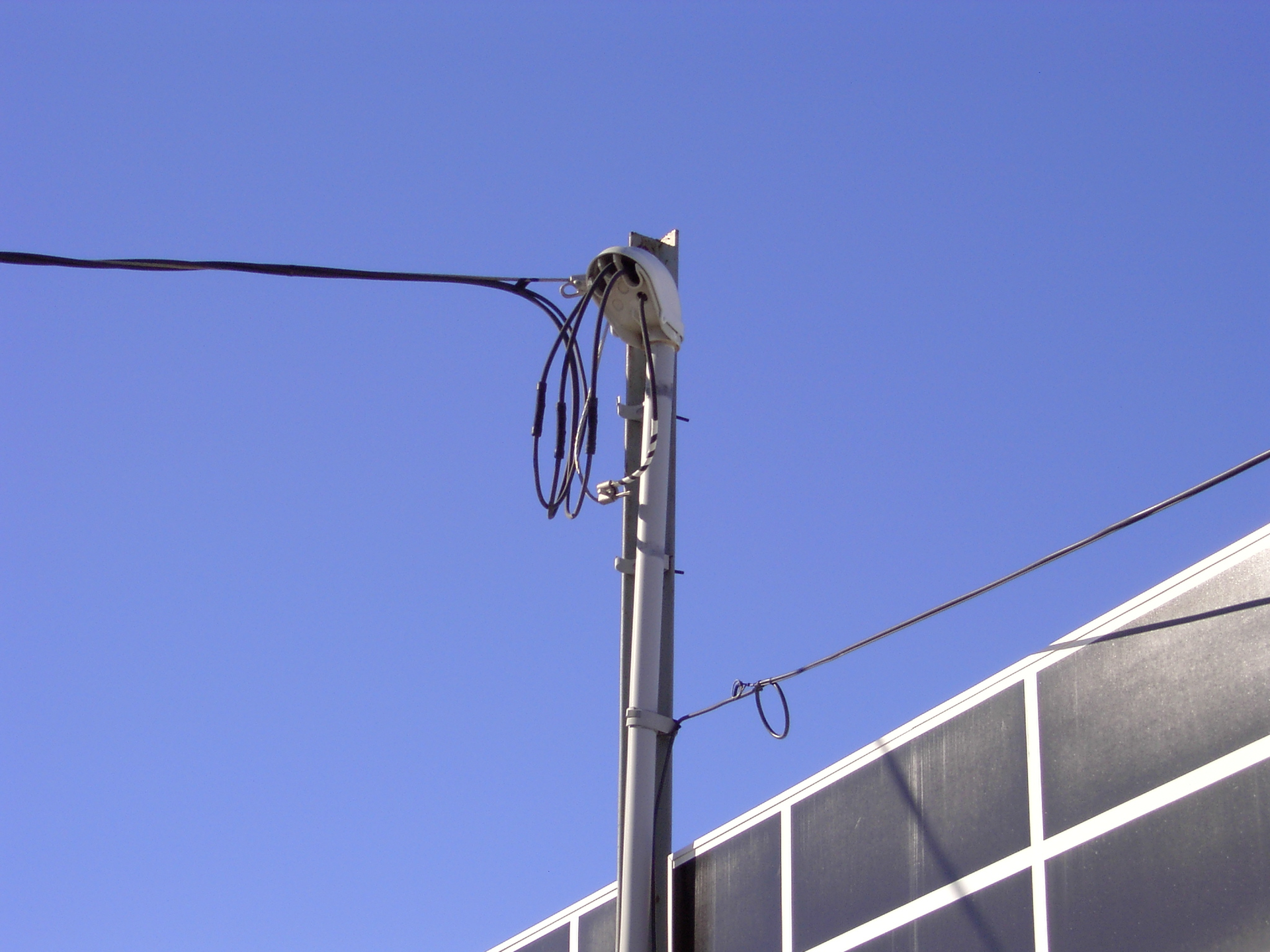

What’s Wrong Here? Hint: Snapped Support Clips
March 25, 2021
A close examination of this Photo will reveal the top two clips used to support this service raceway are broken and snapped apart. The third clip is not too far from being snapped off either due to the communication cable drop being secured to the PVC conduit clip. I’m wondering if that communication cable was the culprit all along. I think it was attached to the top clip originally, and when that clip failed, a repair technician simply attached it to the next one down, and then the third clip down after the second clip failed too. This is speculation on my part, but the clues seem to be leading me to this conclusion.
PVC conduit clips are not designed to withstand the kind of pulling and tugging forces generated from the attached overhead communication cable that can happen during snowstorms and other high-wind conditions. Attaching the communication cable in this manner does not comply with Sec. 800.44. Using PVC conduit clips in this manner does not comply with Sec. 110.3(B). This communication cable should have been attached directly to the steel support beam used to support the PVC conduit.
