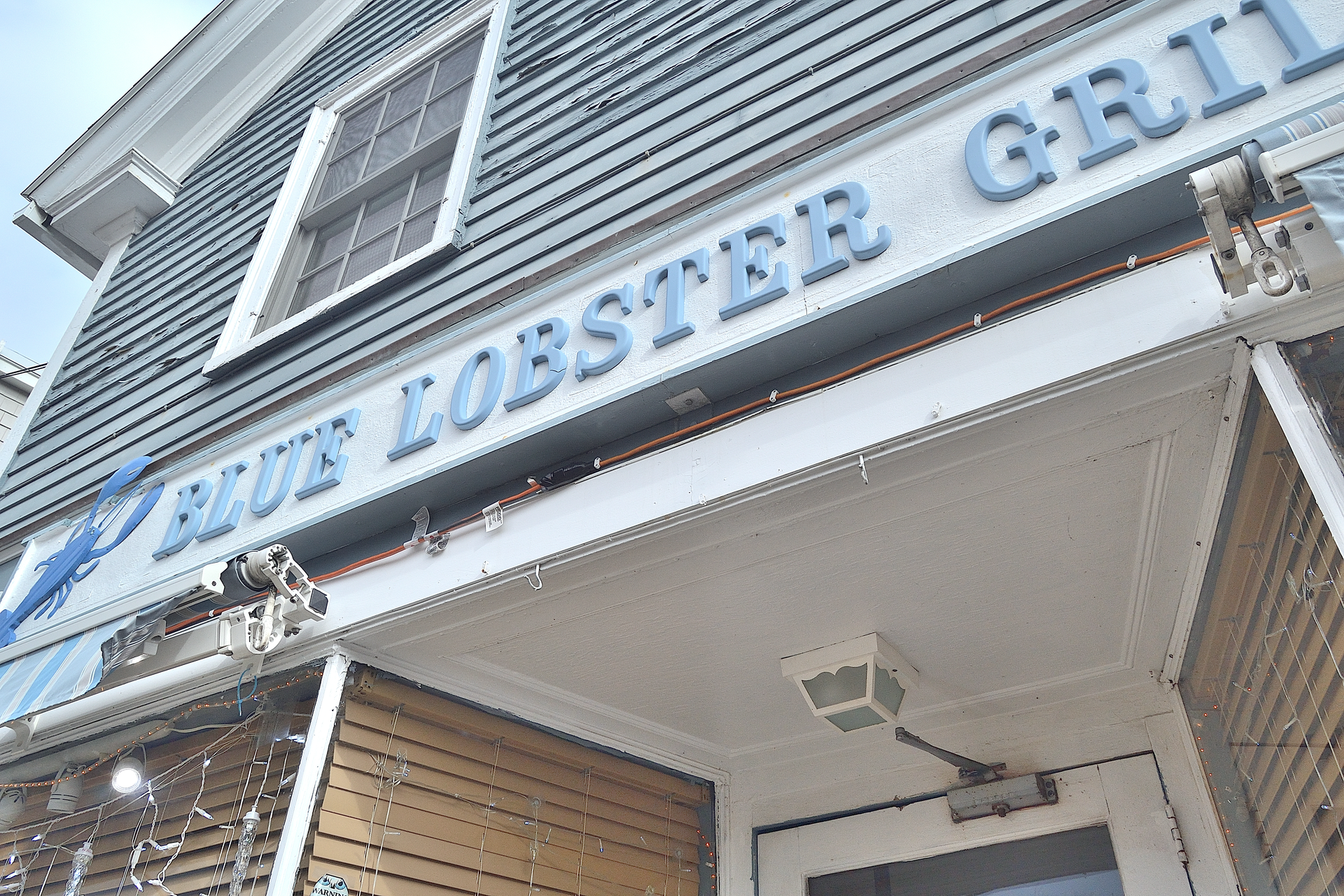

What's Wrong Here? Hint: Is That an Extension Cord I See Below the Sign?
How well do you know the Code? Think you can spot violations the original installer either ignored or couldn’t identify? Here's your chance to moonlight as an electrical inspector and second-guess someone else's work from the safety of your living room or office. Can you identify the specific Code violation(s) in this photo? Note: Submitted comments must include specific references from the 2020 NEC.
Hint: Is that an extension cord I see below the sign?

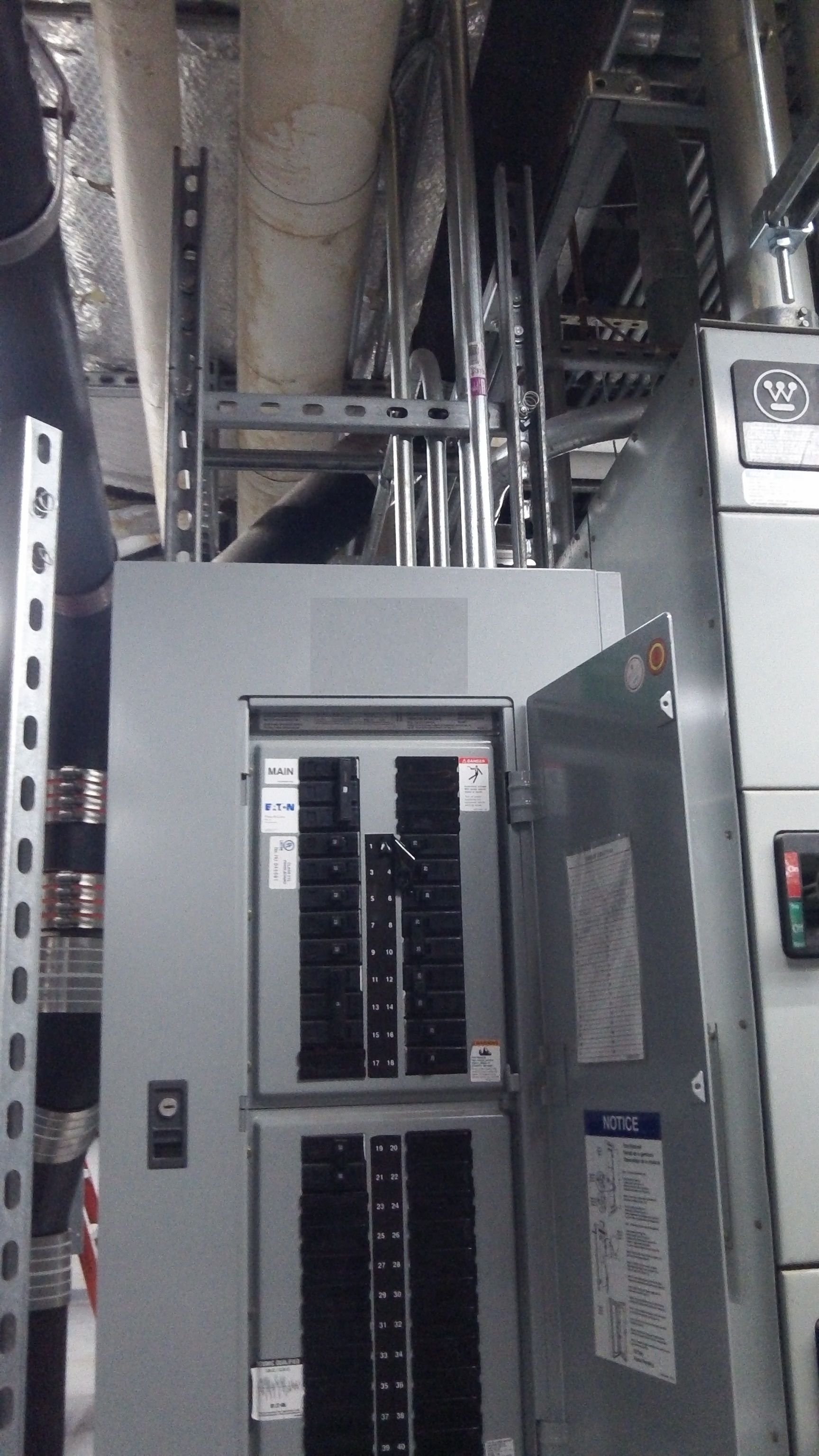

Our winners this month are: Dean Miller, an EC&M reader in Tipp City, Ohio; Hanna Camp, a registered professional engineer with Provost & Pritchard Consulting Group in Bakersfield, Calif.; and Craig Thoroughgood, a master electrician, State of New Hampshire, and air monitoring systems supervisor with Air Resources Division in Concord, N.H. They were all able to correctly cite the working space violation in front of this panelboard enclosure.
The shelving built in front of the panelboard encroaches into the working space required by Sec. 110.26(A). This space must provide working clearance for a minimum depth of 3 ft as specified in Table 110.26(A)(1) — and this space extends from the floor to a height of at least 61/2 ft as required by Sec. 110.26(A)(3). Section 110.26(B) prohibits the required working space from being used for storage. With all the obstructions in front of this panelboard impeding access to the overcurrent devices, we could also cite Sec. 240.24(A), which requires circuit breakers to be readily accessible.
