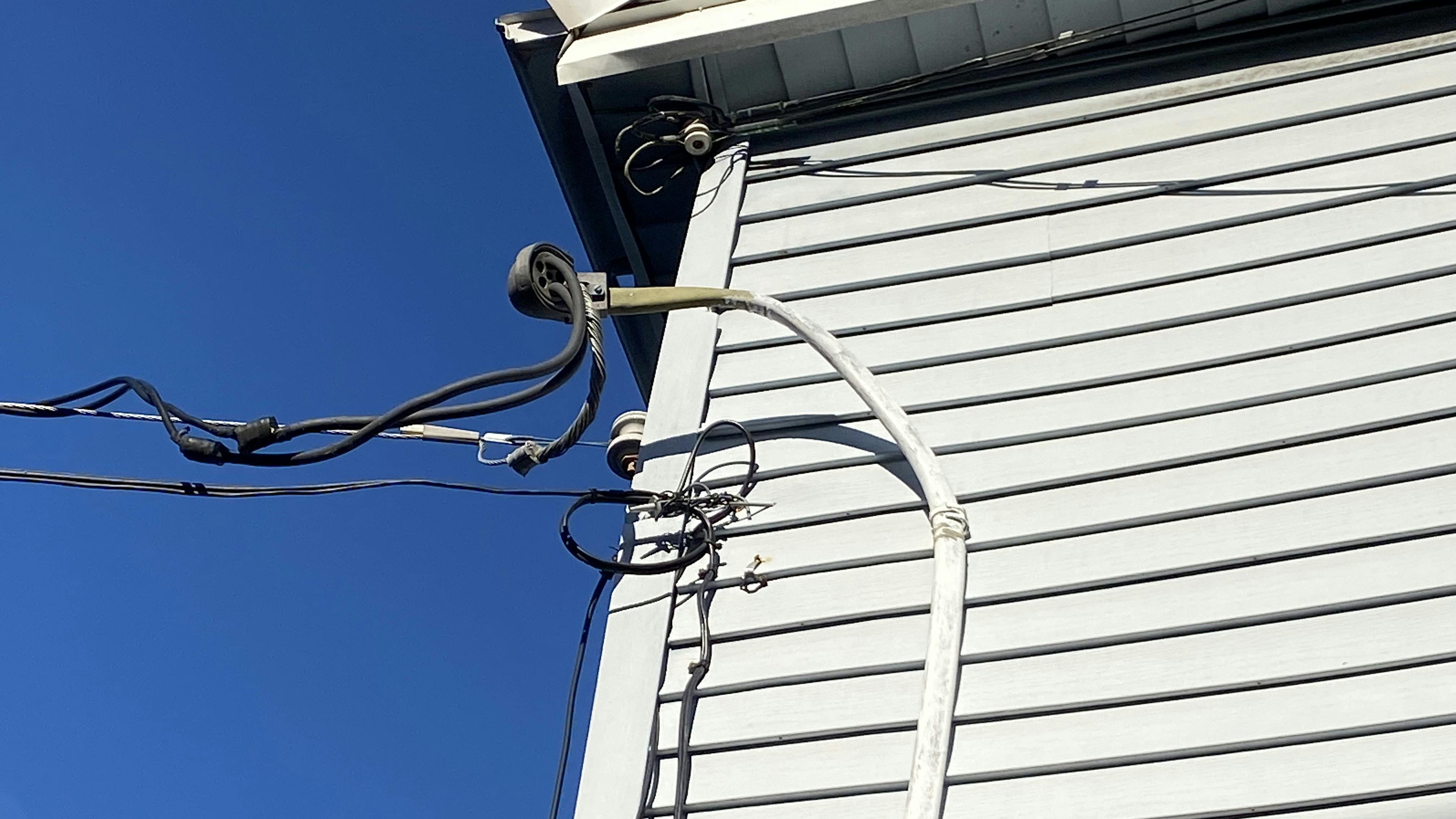

What's Wrong Here? Hint: A Wobbly Weatherhead
How well do you know the Code? Think you can spot violations the original installer either ignored or couldn’t identify? Here's your chance to moonlight as an electrical inspector and second-guess someone else's work from the safety of your living room or office. Can you identify the specific Code violation(s) in this photo? Note: Submitted comments must include specific references from the 2023 NEC.
Hint: A wobbly weatherhead

Unfortunately,  I received no winning submissions citing the violations in this photo. When splicing conductors of NM cables and other cables, Sec. 300.15 provides requirements for when a box, conduit body, or other enclosure is required. Where the wiring method is conduit, tubing, AC cable, MC cable, MI cable, NM cable, or other cables, “a box or conduit body shall be installed at each outlet point, switch point, conductor splice point, conductor junction point, conductor termination point, wiring method transition point, or conductor pull point, unless otherwise permitted in 300.15(A) through (L).” None of the provisions in (A) through (L) apply to this installation. This means those splices must be installed in either a box or a conduit body.
For temporary wiring, Sec. 590.4(G) Exception 1 allows splices on construction sites to be made without being installed in a box or conduit body. The wiring shown in this photo, however, was not temporary — it was permanent wiring installed in the basement of a home. Therefore, Art. 590 does not apply to this installation.
