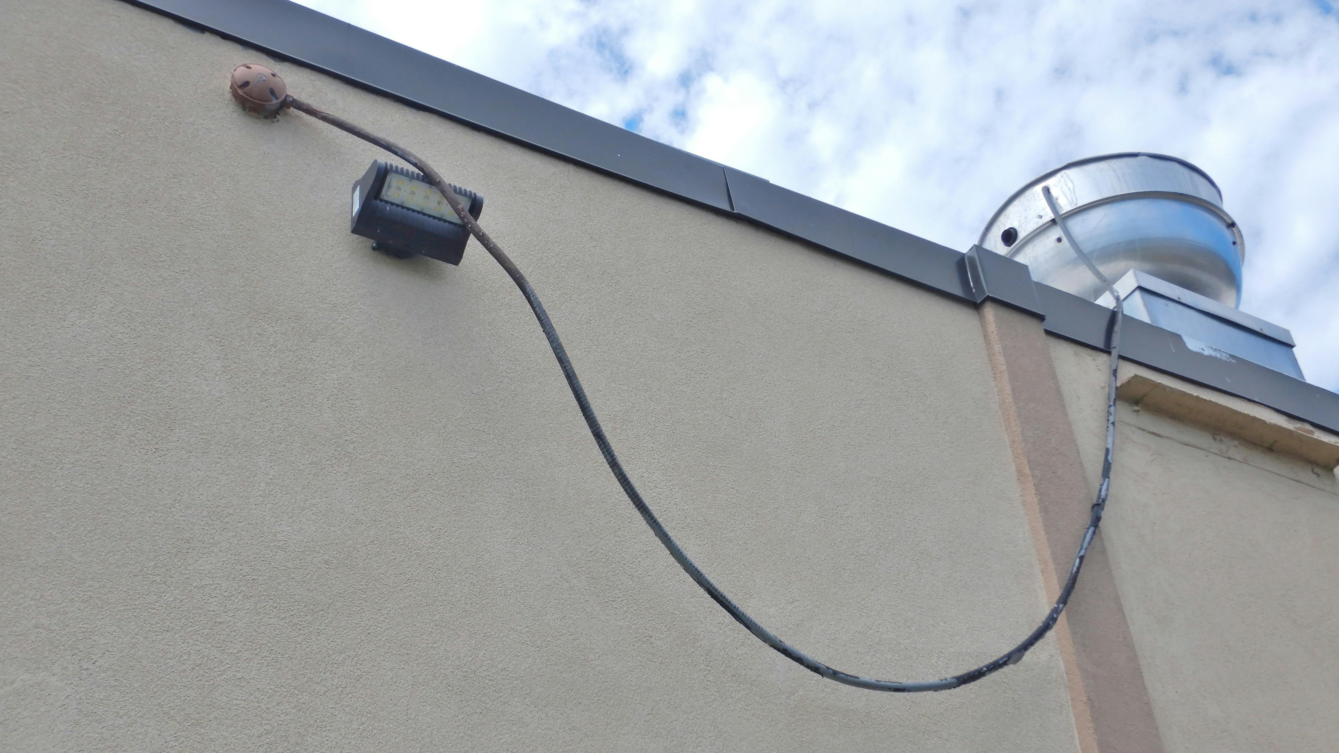

Hint: Now that’s what I call a drip loop!
Holy cow! That is a huge loop of unsupported Liquidtight Flexible Metal Conduit (LFMC) dangling precariously over the heads of the restaurant patrons as they walk through the parking lot. I am estimating the length of the unsupported LFMC to be about 15-18 ft long.
Section 350.30(A) requires LFMC to be securely fastened within 12 inches of each conduit termination and supported and secured at intervals no greater than 4.5 feet. Other than the connectors at each end of the raceway, this LFMC has no other intermediate supports. There are four exceptions to Sec. 350.30(A) allowing different securing and supporting distances, but none of those exceptions allow such a long piece of LFMC to be dangling off the side of this building.
