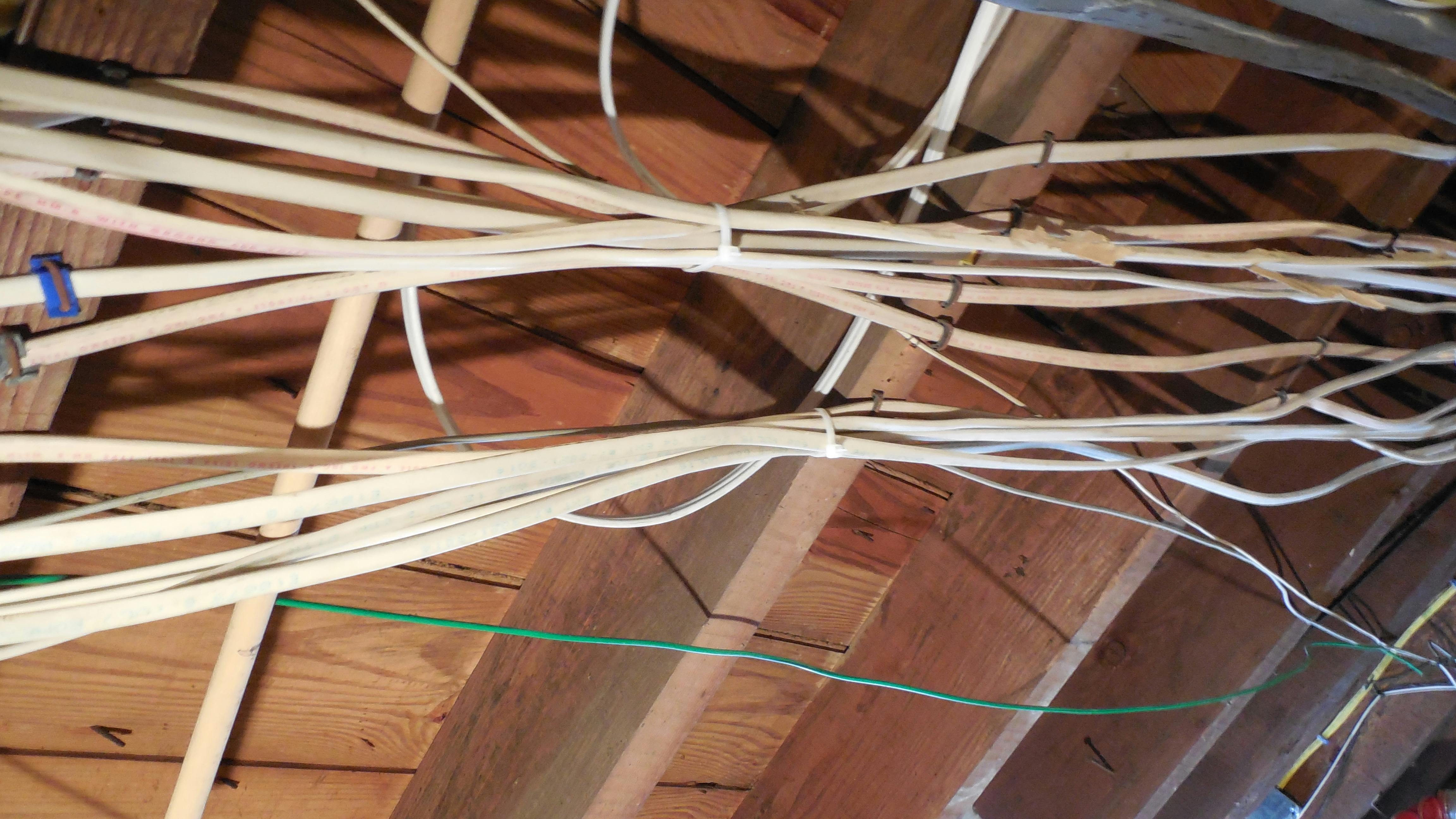

What's Wrong Here? Hint: Subpar Basement Wiring
How well do you know the Code? Think you can spot violations the original installer either ignored or couldn’t identify? Here's your chance to moonlight as an electrical inspector and second-guess someone else's work from the safety of your living room or office. Can you identify the specific Code violation(s) in this photo? Note: Submitted comments must include specific references from the 2023 NEC.
Hint: Subpar basement wiring.

I only received one winning submission this month. Our lone winner was Gregory Pier, senior engineer, MSB Consulting Engineers, Mandeville, La. He knew supporting NM cables to EMT was problematic.
Section 300.13(C) recognizes using raceways such as electrical metallic tubing (EMT) as a means of support for other raceways, cables, and even non-electrical equipment under four specific conditions, none of which applies to the EMT coming out of the top of the panelboard enclosure with the bundle of cables attached to it in this photo. I counted five cables secured to that EMT with cable ties, including two MC cables and three NM cables. These cables are all branch circuits supplying power to various other parts of this building. Section 358.12(2) also prohibits EMT from being used for supporting luminaires or other equipment except conduit bodies that are not larger than the trade size of the EMT.
