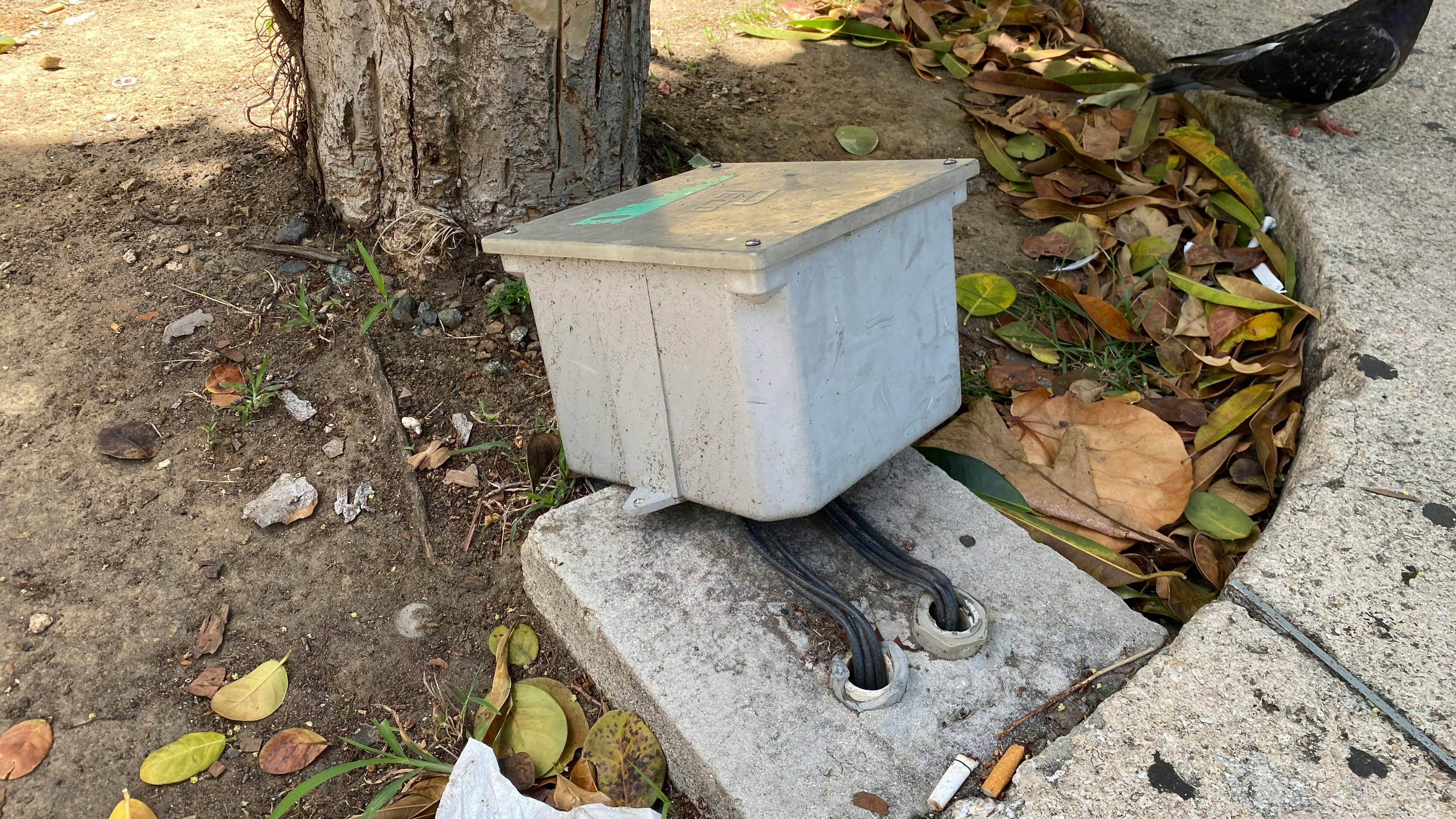

What's Wrong Here? Hint: Busted Box Supports
How well do you know the Code? Think you can spot violations the original installer either ignored or couldn’t identify? Here's your chance to moonlight as an electrical inspector and second-guess someone else's work from the safety of your living room or office. Can you identify the specific Code violation(s) in this photo? Note: Submitted comments must include specific references from the 2026 NEC.
Hint: Busted box supports.

Our two winners this month were Shane Byman, an EC&M reader from Interlachen, Fla., and Brian Dibble, an energy engineer from Troy, N.Y. They both knew these NM cables were not supported and secured correctly.
Section 334.15(C) of the 2026 NEC permits NM cables not smaller than two 6 AWG or three 8 AWG conductors to be secured directly to the bottom of the joists where the cables are run at angles with the joists. However, smaller cables, such as the 12/2 and 14/2 cables in this photo, must be run through holes bored through the joists, or they could be installed on running boards.
They cannot be stapled directly to the bottom of the joists like this.
Another violation is using cable ties to support cables to other cables. This is a violation of Sec. 300.13(D) [Sec. 300.11(D) in the 2023 edition]. A closer look will also reveal that a broomstick has been laid on top of the cable bundles. This is not a storage area, and the cables should not be used to support stored items, such as brooms, hockey sticks, scrap wood, or any other materials.
