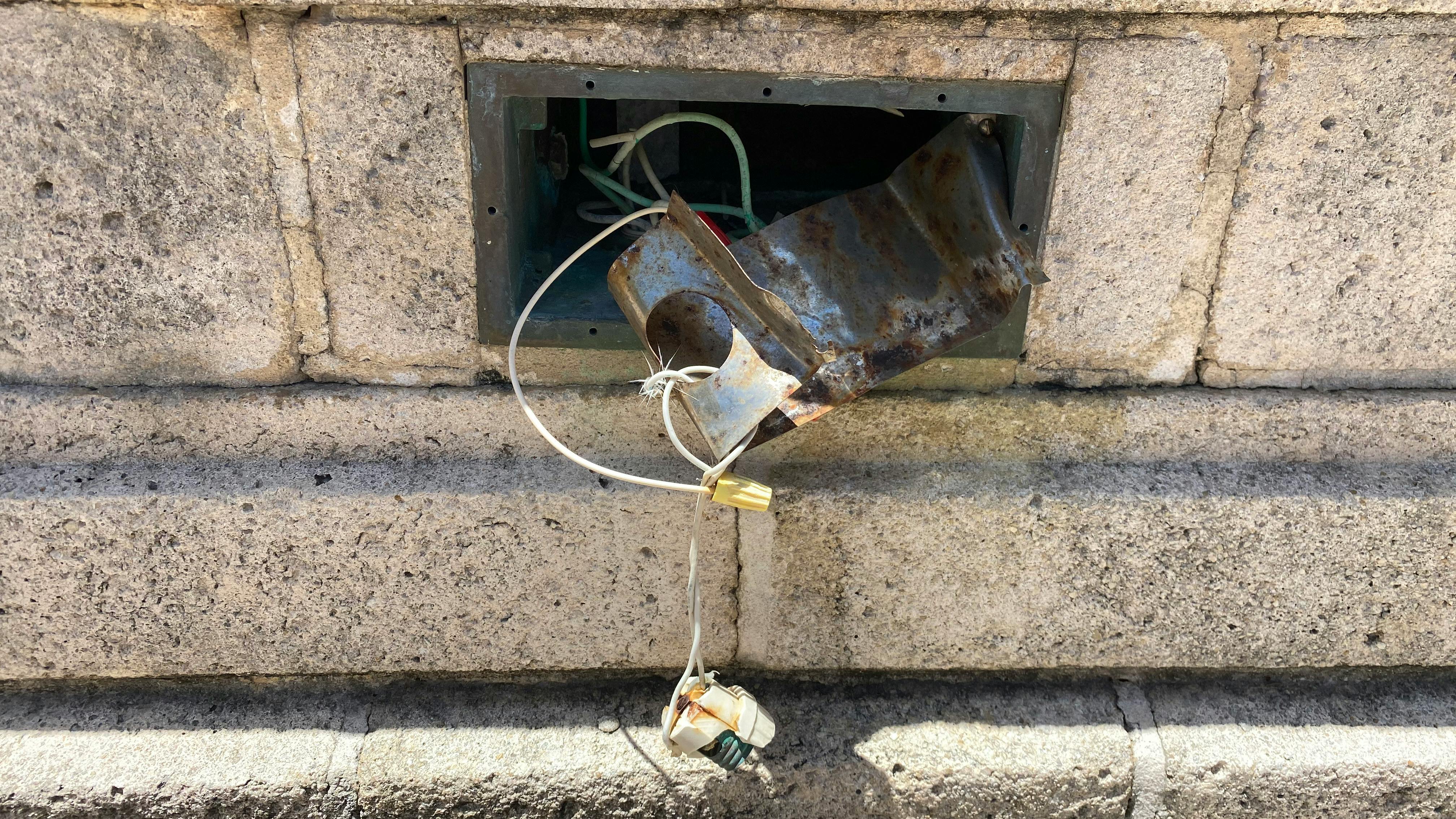

What’s Wrong Here? Hint: Faulty Fixture
Hint: Faulty fixture.
If this wiring is energized, it will pose a serious shock hazard! The porcelain lampholder dangling by its wires is broken leaving the screw shell unprotected and fully exposed. The wire connections on the back of the lampholder are also exposed. The thought of an unsuspecting and curious child finding this mess really makes my blood boil! Wiring disasters like this need to be addressed and corrected immediately to prevent serious harm from happening to anyone.
Section 110.12(B) prohibits broken parts that adversely affect the safe operation of the equipment. Generally speaking, Sec. 110.27(A) requires live parts of electrical equipment operating above 50V to be guarded against accidental contact by installation in approved enclosures. Lastly, this broken fixture no longer complies with Sec. 410.4 which requires luminaires, portable luminaires, lampholders, and lamps to have no live parts normally exposed to contact.
