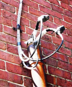

    Can you identify the NEC Code violation(s) in this photo?

    Hint: Something appears to be missing here.

    The most obvious problem is the locknut on the right is installed backward. Although it’s hard to tell in the photo, it also appears there is no locknut on the left side of this nipple. If the “teeth” of the locknut are not facing the enclosure, then proper contact for bonding is not made. For the locknut to function properly as a component of a complete bonding system, it must be securely tight and make proper contact with the enclosure. The way it’s currently installed is a violation of several sections in the Code.
    As noted in 250.96(A), metal raceways and enclosures that serve as equipment grounding conductors shall be bonded to ensure electrical continuity to safely conduct any fault current imposed on them. Additionally, any nonconductive paint shall be removed at contact points or connected with fittings designed to make removal unnecessary. When this type of locknut is properly installed, it will “dig” into the metal surface of the enclosure and create a proper bond.
    Sections 250.4(3), (4) and (5), as well as Sec. 300.10, also make reference to requirements for electrical continuity of metal raceways and enclosures.
