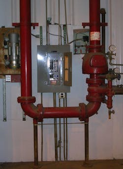

What's Wrong Here?
Hint: Pay attention to the color red.
Sept. 8, 2006
Find the Answer
Jim Malsteed, estimator/project manager with Pleasant Valley Electric, Inc., in Ithaca, N.Y., ran across this panelboard installation in an industrial building, formerly set up to refurbish transformers.
This is a classic example of a violation of the dedicated space requirements for electrical equipment. As per 110.26(F), “All switchboards, panelboards, distribution boards, and motor control centers shall be located in dedicated spaces and protected from damage. Exception: Control equipment that by its very nature or because of other rules of the Code must be adjacent to or within sight of its operating machinery shall be permitted in those locations.”
