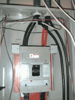

Whats Wrong Here?
Hint: These groups don't get along well with each other.
April 23, 2009
Find the Answer
The supply conductors serving this equipment do not comply with the requirements set forth in 310.4. In addition, the grounded conductors are not properly identified in accordance with 200.6.
To prevent induction from heating the surrounding metal in enclosures or raceways [300.20(A)], you must group all phase conductors (and, where applicable, the grounded conductor) and equipment grounding conductors together.
