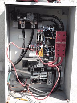

    "We were hired to relocate a generator and its transfer switch," says Steve Tate of White Sands Electric, Pensacola, Fla. "Here is what we found!"
    "If you notice the 240V sensing voltage is connected from the automatic transfer switch to the generator using 18/2 AWG fire wire. The same type of cable is used for the 12V DC battery charger, which is not as dangerous but probably not very effective. They also ran the cable through a ¼ in. drilled hole instead of a bushed connector of any sort. Then it ran free air on the trapeze. The cables are simply strung along the Unistrut trapeze with the conduit (open air) about 9 ft up."
    This basic rule comes to mind when I review this commentary and these photos.
    As noted in 700.5(A), "Transfer equipment, including automatic transfer switches, shall be automatic, identified for emergency use, and approved by the authority having jurisdiction. Transfer equipment shall be designed and installed to prevent the inadvertent interconnection of normal and emergency sources of supply in any operation of the transfer equipment. Transfer equipment and electric power production systems installed to permit operation in parallel with the normal source shall meet the requirements of Article 705."
    Following the manufacturer instructions that come with this type of equipment is the best way to be sure that it is installed properly.
