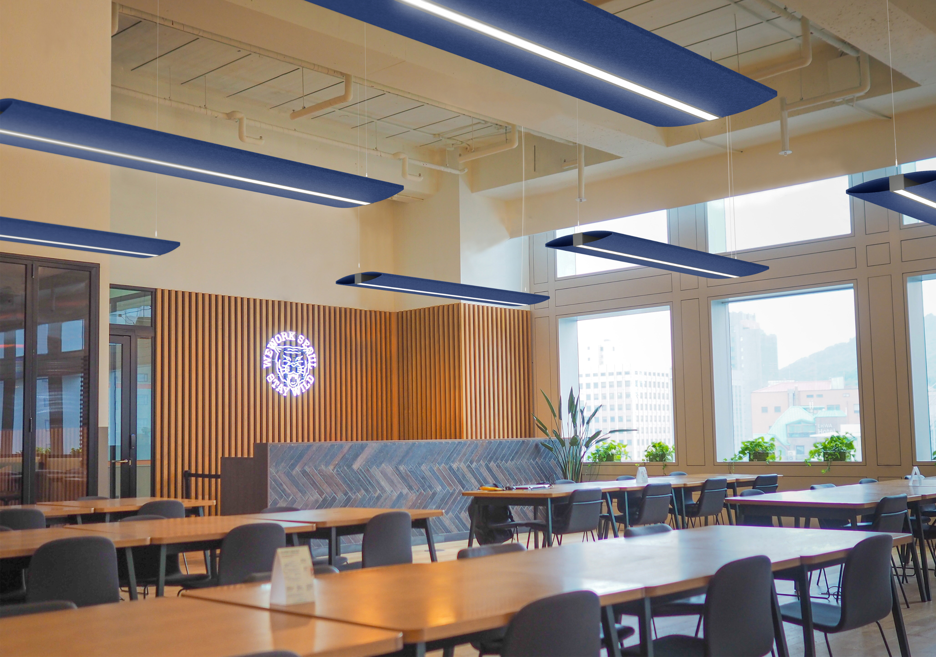

Acuity Brands was recently granted a patent for the innovative design of its acoustic Absorb H family of luminaires from A-Light™, which combines high-performance lighting with acoustic technology. It is designed to reduce noise in open spaces and areas with high ceilings while providing functional illumination. Typical applications include schools, offices, reception areas, lobbies, conference rooms, auditoriums, and convention centers.
The unique double-wall hollow-core shape of the wings allows the Absorb H luminaire to efficiently absorb sound. The luminaire’s felt-like horizontal polyester panels are made from at least 40% post-consumer recycled PET bottles and are fully recyclable. With a large surface area, the acoustic panels limit reverberation time and have an inherent sound absorption rating of 0.75 NRC (Noise Reduction Coefficient). Luminaires are available in 30 varied colors of acoustic material.
