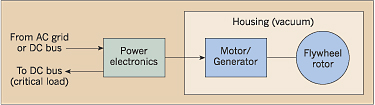

Flywheels. Although an integral part of engine designs for hundreds of years, flywheels are increasingly attracting interest in the power quality arena. In critical power systems, flywheel energy storage systems (FESS) are used to bridge short-term (5 sec to 30 sec) power quality events or to support the load until a fast-start backup generator is activated. Fig. 3 (above) shows a simplified representation of a FESS. Fig. 4 shows a cross section view of one type of flywheel, along with an elevation of its free-standing enclosure with components noted.
According to the presentation noted above, increasing the radius or speed of a flywheel can increase the stored energy. However, this will also increase the internal stress on the material and/or require more sophisticated bearings. As a result, there are two types of flywheels currently on the market: high-speed flywheels (25,000 rpm to 80,000 rpm) made of composite material and low-speed flywheels (2,000 rpm to 10,000 rpm) made of steel.
In a high-speed FESS, a power electronic rectifier/inverter, which is necessary to correct the large volume swing at the generator terminals over the speed range, is connected at the output of the generator. The energy is injected at this point into the DC link circuit of the system. The high-speed FESS has the advantage of compact size for a given amount of power delivered.
On the other hand, low-speed systems are considerably larger than their high-speed counterparts for a given amount of stored energy, their flywheels are made of steel instead of composite materials, and they use conventional bearings with a magnetic support, which is used to support the large rotor weight. Only a partial vacuum is necessary to maintain low frictional losses. These losses, combined with the excitation losses, result in a float charge that's roughly double that of typical high-speed storage systems.
Like the high-speed FESS, most low-speed FESSs use either a single-stage insulated gate bipolar transistor (IGBT) or a rectifier/inverter for power transfer. Some operate with an induction or mechanical coupling instead of this DC interface. The former coupling type can be used to correct for changing rotational frequency. The latter coupling type, however, must compensate for this through power electronics that act as a 3-phase exciter winding in the generator.
