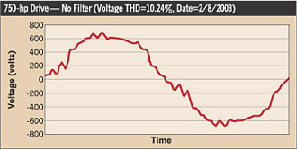

In February 2003, the resort hired an electrical contractor, at the manufacturer's request, to take power measurements at the pumping station. The contractor's measurement team could only run the 750-hp drive at approximately 50% load because of the prevalent problem with power line and transformer capacity. Figure 1 (above) shows a plot of the voltage waveform of the 750-hp VFD without any harmonic filter/capacitor support. Figure 2 (below) shows a plot of the current waveform of the same VFD ¡ª again with no harmonic filter support.
The harmonic filter/capacitor manufacturer then made calculations of horsepower and power (Table 1, below) and compared them to calculations derived from the actual measurements (Table 2, below). The manufacturer then evaluated a scenario where both the 350-hp pump and the 750-hp pump were running at 120% of expected load. The manufacturer found that the kVA required for both pumps would be 1,065kVA, with 313A of 5th harmonic current. With these numbers and 10.24% voltage total harmonic distortion (THD) plus 30.78% current total demand distortion (TDD), it was no wonder the power line and transformer could not handle the load. (See ¡°Harmonics and Their Effect on Power Factor,¡± .)

In December 2003, the electrical contractor again took measurements ¡ª this time at the point of common connection (PCC) of the drives and harmonic filter ¡ª to verify the operation of the filter/capacitor (Table 3, above). These measurements were derived from plots of voltage and current waveforms (Figs. 3 and 4, below) with the harmonic filter online.
Note that the kVA was reduced from a calculated value of 1,065kVA to 964kVA. Also, the voltage increased from 474V to 492V. Finally, the 5th harmonic current was reduced from a calculated value of 313A to 59A. The harmonic filter had injected 424kVAR of reactive power in the system.
