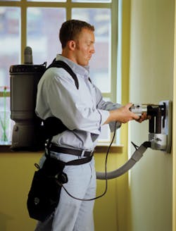

Electricians often waste valuable manhours cleaning up drywall dust following a residential electrical installation. Stan Brannan, president and chairman of Wichita, Kan.-based Python Tools, says that electricians are too talented to serve as janitors. To increase electricians' productivity, he and inventor Greg Tillemans have introduced the Python Perfect Cutter, a tool that allows electricians to quickly and easily cut a clean, precise electrical hole without scattering dust into the air. A built-in vacuum holds one of the interchangeable electrical templates into place and then sucks up the dust as the hole is being cut.

With the Perfect Cutter, an electrician can cut a hole in drywall in less than a minute and even make multiple holes at exactly the same height. The tool's height rod kit often comes in handy in an office environment, when electricians need to install several Internet jacks in a row. Rather than using a sawing motion, the tool features a high-speed router, which produces precise holes in materials like lathe, plaster, tile, and paneling. Users simply place the template against the wall and then punch a button, which causes the vacuum to turn on by radio remote control. The vacuum creates a suction to hold the template in place, as well as collect the dust created by the cutting process. The electrician then has two hands free to run the router along the inside edge of the template and quickly and accurately cut a hole in the wall's surface. Tillemans says the tool makes professional electricians look more professional.
