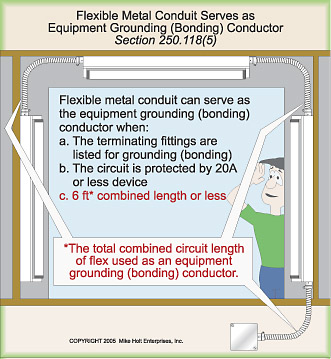

Listed flexible metal conduit — FMC installations must meet four requirements [250.118(5)(a)-(d)]:
  • The conduit terminates in fittings listed for grounding.
  • The circuit conductors are protected by overcurrent devices rated 20A or less.
  • The combined length of the conduit in the same fault return path doesn't exceed 6 feet (Fig. 1).
  • The application requires flexibility.
