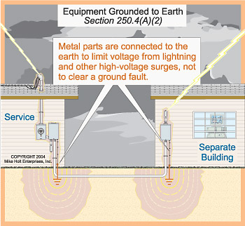

Grounding and bonding in grounded systems. The NEC requires you to ground (earth) system windings to limit the voltage imposed on the system by lightning, unintentional contact with higher-voltage lines, or line surges (Sidebar below). Another function of this earthing is to “stabilize the voltage to earth during normal operation” by providing a common reference point.
The NEC also requires you to ground (earth) metal parts of electrical equipment in or on a building or structure. See 250.24(A) for services and 250.32(A) for separate buildings or structures. You accomplish this grounding (earthing) by using a grounding (earthing) electrode conductor [250.64(A)] to electrically connect the building or structure disconnecting means (225.31 or 230.70) to a grounding (earthing) electrode [250.52, 250.24(A), and 250.32(A)] (Fig. 1 above).
However, grounding (earthing) has its limitations. Grounding (earthing) of electrical equipment doesn't provide a low-impedance fault-current path to clear ground faults. In fact, the Code prohibits the use of the earth as the sole return path because it's a poor conductor of current at voltage levels below 600V [250.4(A)(5) and 250.45(B)(4)].
In addition, grounding (earthing) the metal parts of electrical equipment doesn't protect electrical or electronic equipment from lightning-induced voltage transients (high-frequency voltage impulses) on the circuit conductors inside the building or structure. Nor does it protect equipment within a structure from transients generated from other equipment in that structure.
To provide protection from voltage surges, you must engineer a proper surge protection system. The design should address surge protection devices (Art. 280 and 285) at service equipment, panelboards, and critical loads. Although it isn't covered by the NEC, you could also consider point-of-use surge protection in branch circuits.
