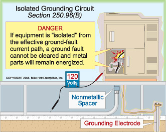

An example of a supplementary electrode is a ground rod installed next to a machine tool. Such an electrode serves no electrical purpose. Yet, some equipment manufacturers require independent electrodes. They insist that their equipment be electrically isolated from the structure's electrical system [no equipment grounding (bonding) conductor].
This practice violates 250.4(A)(5), which prohibits the use of the earth as an effective ground-fault current path. If the metal enclosures of sensitive electronic equipment were isolated or floated as required by some equipment manufacturers, dangerous voltage on metal parts would remain from a ground fault (Fig. 1).
You can isolate a metal raceway (containing circuit conductors for sensitive electronic equipment) from the electrical equipment it supplies by using a nonmetallic raceway fitting located at the equipment. However, the metal raceway must contain an insulated equipment grounding (bonding) conductor to provide the effective ground-fault current path to the power source (250.96) (Fig. 2).
