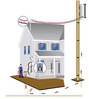

The case of the open neutral. In a properly functioning electrical system, the neutral conductor carries the imbalance current of the system. For a single-phase system, the imbalance is the difference between the currents in the two “hot” legs of the transformer. For a 3-phase system, the neutral current is the imbalance between all three hot phases. To further clarify this point, let's review an example, starting with the review of a single-phase 120/240V system.
The current imbalance needs to return via the neutral conductor back to the transformer. But, if that neutral is open, the imbalance current will seek other paths to get back to the neutral leg of the transformer. At the main service, the neutral and ground are connected via the main bonding jumper. If the ground path has a low enough resistance, it may prove to be a satisfactory return path, and the imbalance current will travel through the main bonding jumper into the grounding electrode. Since the transformer neutral is grounded by the utility, and since the main bonding jumper connects the neutral and grounding conductor at the service, as per NEC requirements, the ground path provides a complete return for the imbalance current.

Your neighbor's problem is now your problem. Let's take a look at another example. This time you're working in a building or a house, and you're sure there is a continuous neutral. You look at the service entrance conductors, and don't see any breaks. Everything appears to be in good condition, including the neutral conductor and all neutral connections. You are convinced that since there have been no complaints about fluctuating voltages, or any other indications of an open neutral, that a neutral problem at this building doesn't exist. You even go as far as measuring current in the neutral, and convince yourself that since there is current in the neutral conductor, there can't be an open neutral. This leads you to have no fear of opening up any grounding electrode conductors. Is this a safe assumption?
Even though the building you're working on may have a completely continuous neutral back to the transformer, the house next door or a building somewhere in the general vicinity may have an open neutral. If the building you're working in and the building with an open neutral have some type of conductive path between them, current may return via that path. A metal water pipe is a good example of such a connection. Current can come “up” through a ground rod or a water pipe into the building you're working on, due to an open neutral in a neighboring building. Figure 3 on page C16 illustrates this condition. The metal water pipe common to the buildings has such a low resistance, that it may not be apparent at the building with the open neutral that there is a problem. The current exits the building with the open neutral through the metallic pipes and finds its way back up through the grounding electrode conductors in your building. Any grounded electrically conductive path between buildings can serve as a return path for current for a building with an open neutral.
The grounded coaxial braid in the jacket of cable television drops can also serve as return paths for the neutral imbalance current from a building with an open neutral (Fig. 4). Cable television systems should be grounded as they enter the premises as per Art. 680 of the NEC. Since the cable television connection blocks typically get grounded directly to the same grounding electrodes that the electric service uses (or they have their own separate grounding electrode, and that electrode gets bonded to the electrical system grounding electrode), this can become a return path. However, this situation is quite rare, since the ampacity of the return current tends to burn out the coaxial cable). Nonetheless, it can still exist and create a hazard.
