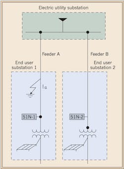

The primary ground fault might occur outside of the zone of protection of the most upstream end-user protective device (e.g., see 51N in Fig. 1 on page 28), but still within the service entrance of the facility.
Electric utilities may require that such zone of protection should be limited so as not to comprise the upstream area, which might include the incoming cables. The concern is the end-user’s protective device might trip upon ground faults involving the supply feeders. The reason for this restriction is exemplified in Fig. 2.
Fig. 2. Nuisance tripping caused by ground faults occurring along electric utility feeders.
A ground fault occurring along the electric utility Feeder A (which supplies End-User 1) should not trip the protective device 51N-2 of End-User 2; this might happen if the zone of protection of 51N-2 included the upstream network. In this case, the continuity of service to multiple users would be compromised because of a single fault.
To prevent the loss of multiple services, electric utilities selectively clear the ground fault by isolating the faulty line. The downside aspect of this solution to the end-user is that both magnitude and duration of touch and step voltages are variables not under the user’s control. Therefore, it is clear that electric utilities should provide single-phase, line-to-ground fault current (If) and fault duration (tf) values to electrical designers to allow the minimization of touch and step potentials through the proper design of the substation ground grid.
