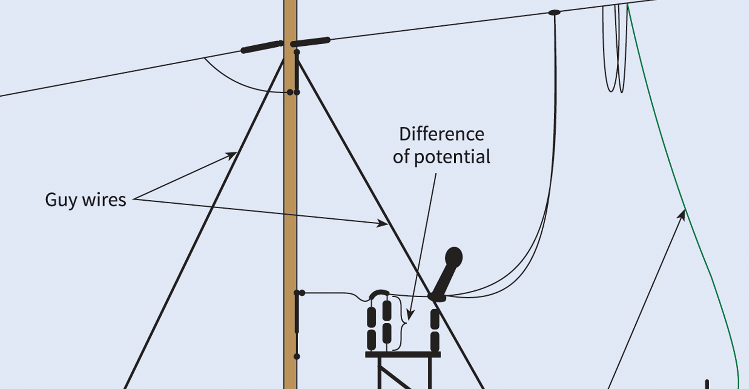

In July 2013, a utility contractor crew foreman was fatally injured while preparing to remove a jumper from a sectionalizing disconnect switch on a 115kV transmission line. The plan of the day was to relocate two 115kV sectionalizing disconnect switches. There were two crews on the job working independently.
Crew 1 established an equipotential zone (EPZ) between the switch structure, the sectionalizing switch, the wood pole down ground, the driven ground rod, and the 115kV transmission line conductors. Crew 2 did not establish an EPZ because they did not bond the driven ground rod to the switch, thereby establishing two different ground potentials between the switch stand and the switch (see the Figure).
The foreman climbed up to the top of the switch stand to attach lift slings suspended from a crane. Once the lift slings were placed and pulled up snug, he positioned himself to assist in the removal of the blade end-sectionalizing jumper on B-phase. At this point, he made contact with a difference of potential across the blade end of the insulator. The accident board concluded that the root cause of the fatal event was the crew’s failure to establish an EPZ.
