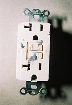

Examination of the temporary power pole revealed it included four 120VAC GFCI-type duplex receptacles downstream of two 20A circuit breakers (two receptacles supplied from each circuit breaker). The components were mounted in an outdoor-type box with a damaged cover that would not properly close. The GFCI receptacle identified as the unit supplying temporary power through the NM cable was then removed for detailed laboratory examination (Photo 1). During this removal, proper supply connections within the temporary power pole assembly for that receptacle were confirmed, including bonding connection. It was verified that the neutral and ground were bonded together within the main service panelboard in the house — and that there was a bonding connection to the copper piping within the house from the panelboard grounding electrode connection point.
The diagrammed temporary terminations for the NM cable would have the effect of connecting the GFCI receptacle outlet hot leg with the service entry neutral in the house where the plumbers were working. This would have resulted in energization of any exposed bonded metal, including the furnace and water heater casings and metal piping, at voltage levels potentially up to 120VAC.
The GFCI receptacle was confirmed as a UL-listed 20A rated indoor-only-type assembly with front-mounted “test” and “reset” buttons. The receptacle exterior evidenced some age and weathering, including heavy corrosion of the screw heads that secured the plastic casing. Investigators also confirmed that when connected to a nominal 120VAC supply, the outlets were live — a condition that did not change when the GFCI test button was pushed. During disassembly, the receptacle internals evidenced significant contamination from dirt, insect remains/webs, and other debris. External corrosion from probable water intrusion also was apparent. The unit evidenced heavy overheating/burn damage to the circuit board (Photos 2a, 2b, and 2c). Provided information indicated this GFCI receptacle was probably at least five years old. Based on these findings, it's unlikely that the GFCI circuitry would have reacted to the expected ground leakage currents and shut off power, following connection of the outlet hot leg to the house grounded conductors as described above.

The GFCI receptacle involved in this incident was a listed product that had been improperly exposed to weather over a long time period. The receptacle was installed in a temporary power pole that was one of reportedly many belonging to the electrical contractor for this project — and which supposedly had been reused at many locations. Apparent in this case was a lack of preventive maintenance or testing by that contractor, who should have identified the failed weather protection and the degraded receptacle condition and nonfunctional protection long before the time of this accident. Electrical contractors should have programs in place for tracking, inspecting, testing, and maintaining such equipment — for the protection of their own employees as well as others. This will also help to avoid financial consequences such as those resulting from the litigation following this tragic accident.
