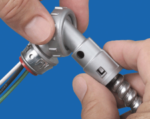

The Snap2It Zero to 90° connector is a metallic fitting for AC, MC and 3/8-in. flex cable. It ships straight but adjusts to any angle between 0 and 90° by simply loosening the nut, adjusting the angle, and retightening the nut. No tools are required, and no damage is done to the wire. It installs in about 8 sec, saving a full minute per connector over 2-screw/locknut styles. Arlington Industries Inc.
