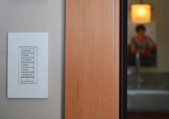

A multi-button keypad allows an installer to set up multiple pre-set lighting scenes for a homeowner (Photo courtesy of VMA Electric).

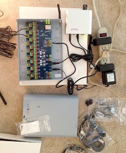

For example, after completing a two-week training session with the manufacturer, Archila installed a promotional installation kit in his own home. This gave him the opportunity to test the programming features and ensure everything communicated properly together and also back to the main source.
This device uses CTs to monitor PV production and individual circuits, and provides web-based visual monitoring and automatic load shedding to help reduce utility demand pricing expense (Photo courtesy of Mark Snyder Electric).

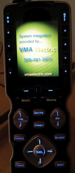

VMA Electric custom programmed a remote to make it easier and more convenient for a client to control the systems within the home (Photo courtesy of VMA Electric).
