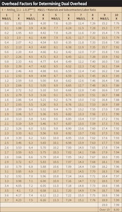

Values for X used from Table 1 are determined by the materials and subcontract-to-labor ratio and are found in the table of overhead factors (Table 2). Values for overhead, labor, materials and subcontracts are provided from the company’s budgeted profit and loss statement.

 After the materials and subcontracts-to-labor ratio (M&S/L) is calculated, the overhead factors in Table 2 is consulted to find the X value of that M&S/L. For example, an M&S/L of 0.5 yields an X of 2.13, and an M&S/L of 2.0 yields an X of 3.13.
For the hypothetical contractor’s M&S/L of 2.92, the X factor must be determined by interpolation. The X factor for 2.9 is 3.72; the X factor for 3.0 is 3.80. Since 2.92 is 20% of the difference between 3.0 and 2.9, added to 2.9, the X factor for 2.92 is 20% of the difference between the X factors of 3.72 and 3.80, added to 3.72.
0.20 x (3.80 - 3.72) + 3.72 = X
(0.20 x .08) + 3.72 = X
0.016 + 3.72 = X
3.736 = X
If we round to hundredths, then the X factor for an M&S/L of 2.92 is 3.74. To determine the dual rates, we need to substitute 3.74 for X and perform the calculations illustrated in Table 4. Thus, the dual-overhead rates are 15.56% of materials and subcontracts cost and 58.2% of labor cost with the M&S/L of 2.92.
