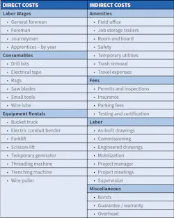

Project costs are comprised of direct and indirect costs. These costs include both labor and material items. The Table lists the possible direct and indirect costs for a labor-only project. Of course, not every project will include all of these items, as the scope of work and type of project will determine these costs.
When submitting a price to install a project as per plans and specifications, the bid price must include all labor (direct and indirect), indirect material costs, and project-related equipment, which might include, but not be limited to, any of the following: threading machines, wire pulling equipment, trenching machine, forklift, etc.
