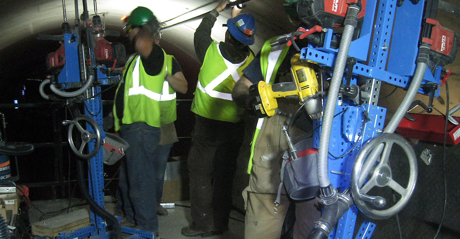

    “Drilling overhead into concrete is like holding a noisy, vibrating 50-pound box above your shoulders while dust drops into your face and eyes — while you’re standing on a ladder,” says Dr. David Rempel of the Ergonomics Program at the University of California-San Francisco and the University of California-Berkeley, in a CPWR case study.
    After listening to concerns voiced at a safety conference, Dr. Rempel and his team took action by forging a partnership with 20 contractors and labor unions. Together, they researched ways to keep workers off ladders when drilling overhead.
    By engaging more than 100 workers in California, Oregon, and Washington in field testing, the team developed four generations of support devices for overhead drilling. These devices allow electricians to work with less fatigue in the neck, shoulders, hands, arms, lower back, and legs without reducing productivity, per CPWR.
    Based on their research, two manufacturers developed jigs for supporting rotary hammers during concrete drilling. An inverted drill press, designed for drilling into concrete ceilings, allows electricians to perform work from the ground level by raising a drill up to 15 feet. Electricians can also use a heavy drill support system, which is designed for drilling overhead and at other angles, for installing large conduit overhead and inserting anchors for other tasks (Photo 2). By minimizing fatigue, an electrician can take fewer breaks and have more control, depth and precision on the job, Miller says.
    Photo 2. Support devices are used to reduce neck, shoulder, hand, arm, lower back, and leg fatigue during overhead drilling activities.
