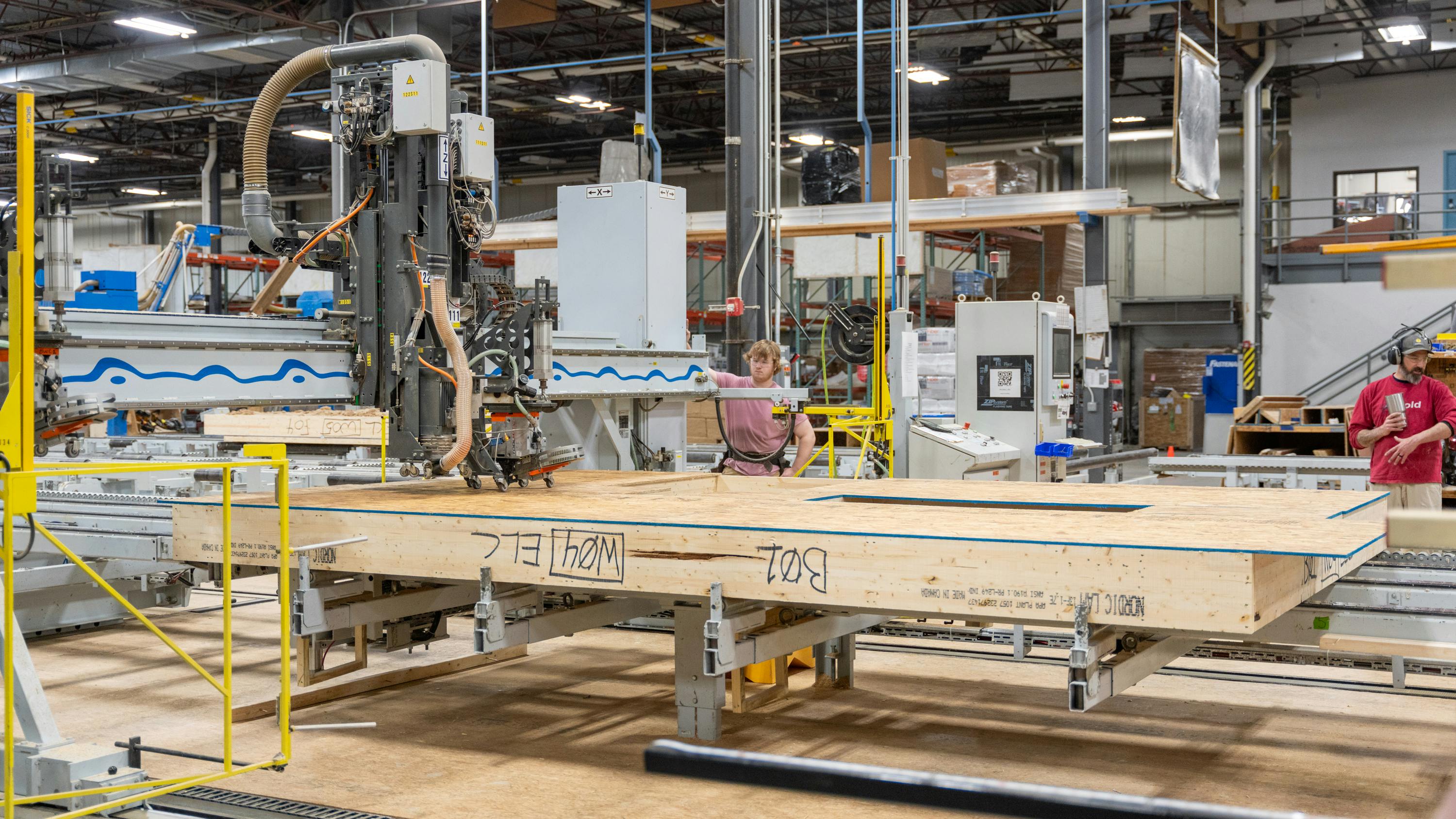

    Factories enable the use of automation that’s not possible on job sites. An example is a CNC machine that cuts a floor joist to length and then drills the holes for plumbing and electrical runs — all in one pass rather than the multiple steps of traditional site building. But that still leaves plenty of site work for electricians.

    Some single-family modular and panelized homes use a similar approach. For example, Bensonwood builds exterior walls with the traditional sandwich of siding, sheathing, framing, and insulation, but it’s followed by a non-structural interior framework of 2x3s that serves as a chase. The drywall, beadboard, or other finish layer is installed on the job site once the MEP work is done.
    “All the installation is done on site by local electricians,” says Seth Clarke, director of preconstruction at the Walpole, N.H.-based company.
    This “service layer” provides a couple of benefits. First, having a dedicated space for electrical, telecom, IT, and plumbing means that their installation doesn’t require drilling and sawing through insulation and vapor barriers, thus preserving the energy-efficient building envelope. It also preserves structural strength because the studs, cripples, plates, and headers are never touched.
    "Our CNC equipment notches out the back side, so you have all the raceways already precut into the service layer and then falling into the partitions," says Hans Porschitz, Bensonwood operations officer. “The machine is also drilling holes at the same height. We're creating efficiency for electricians on our job sites so they don’t have to drill a bunch of holes. They just pull those runs before the interior finish goes on.”
    A second benefit is long term and ties in with the sustainability goal of factory-built housing. Decades from now — when the home is remodeled — or when new technologies arrive, those changes can be made entirely in the service layer faster and cheaper.
