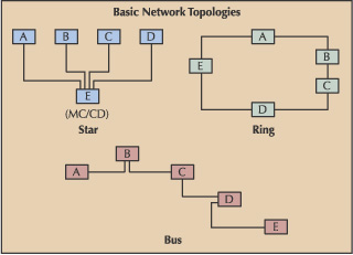

Network topologies vary. The topology of a network is its layout scheme. It can become difficult, however, when the physical layout of the network, or its physical topology, differs from the way in which the network exchanges information, or its logical topology. CO-OSP networks are similar in structure to premises networks. The three main topologies—star, bus, and ring—can be combined in a number of ways to produce hybrid networks offering workable solutions to many different geographical constraints and administrative concerns (Fig. 1).
All other factors being equal, the star is the preferred configuration for outside-plant installations. The star arrangement provides a central hub from which the network administrator can manage the physical network. If possible, this main cross-connect (MC) or campus distributor (CD) should be co-located with the enterprise’s data center.
If the distances spanned by a campus network exceed the transmission distances allowed by a star topology, the hierarchical star is a hybrid arrangement that may solve the problem. In this arrangement, an intermediate cross-connect (IC) or building distributor (BD) at one “point” of the star links buildings still farther away from the hub. Ideally, such IC/BDs should be linked to outlying buildings via a star topology, and no more than five such “hierarchical stars” should be designed into any one-campus network (Fig. 2).
Hierarchical stars are best used when geographical constraints make a single star configuration impossible, or when user requirements make it advisable to segment the network. In large networks, active electronics such as bridges and switches can often be used more effectively to balance bandwidth requirements and distance limitations with such a topology.
Ring-shaped networks come in two varieties: virtual rings and physical rings. Virtual rings have the physical topology of a star-shaped network but operate logically as a ring. Physical rings are widely used in CO-OSP networks because the networking technologies employed on a campus often call for a ring-shaped infrastructure; examples of such LAN and WAN technologies include Token Ring, SONET (synchronous optical networking), ATM (asynchronous transfer mode) and FDDI (fiber distributed data interface) (Fig. 3 above).
A virtual ring is used when obstacles on the campus prevent a physical star from being implemented, and when existing star-topology cabling facilitates such a design. Its main advantage is that it concentrates monitoring, maintenance, and backup operations at a central hub. However, this hub also is the scheme’s main disadvantage, because it’s a central point of failure in the event of a disaster.
The physical ring topology is used when there is a conduit system in place to support it, redundant cable paths are provided, and the predominant networking technology is ring-shaped, such as SONET, FDDI, or Token Ring.
A bus topology (Fig. 1) can be used when a fault-tolerant design isn’t required. The linear bus design is of limited use because it will fail if a cable break occurs anywhere in the network. It doesn’t provide backup or redundant transmission paths, so it can’t be used for mission-critical applications.
