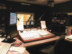

Q. Does under-loading of a transformer at as low as 25% to 30% of the rated capacity increase harmonics and adversely affect power quality in a local distribution system? The transformer in question is K-13 rated and supplies audio/video (A/V) power supply loads. Does power quality affect performance of A/V equipment so drastically that the transformer should be changed to a smaller one?
