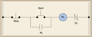

Typical Motor Control Circuit Schematic Prompts Reader Inquiry
While I don't profess to be the world's greatest authority on electrical construction and design, I have learned a few things in the last 40+ years. On page 20 of the April issue, there is a ladder diagram (Fig. 3) that shows a typical 3-wire motor control circuit. Oops!
This circuit, as shown, will never start the coil of this contactor due to the fact there is no power available to the START button. I seem to remember that a STOP push button is always wired normally closed (N.C.), which puts power to the START button. I do hope this was just a typo. I'd hate to think I've been wiring them wrong all these years.
— Thomas R. Wolf, Sr.
Author's reply: The STOP push button is normally closed (N.C.), and the start push button is normally open (N.O.). Please note the ladder diagram does show a NC push button for STOP and a N.O. push button for START. However, the illustration for the N.C. STOP button should have shown the line a little closer to the two dots. Standard practice is to show the line below the two dots for a momentary N.C. push button, and the line above the two dots for a momentary N.O. push button. I hope this helps clear up any confusion. The corrected graphic of a typical 3-wire control circuit is shown above.
— Steve Vidal, president of Joseph J. Vidal & Sons, Inc., Throop, Pa.
