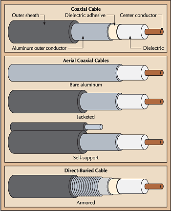

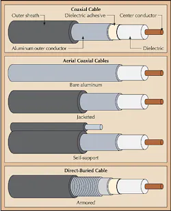

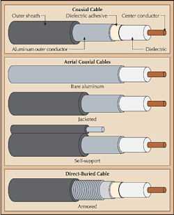

Coaxial cable.
By definition, a coaxial cable consists of two metallic conductors sharing the same axis. Coax has a metallic center conductor, coaxially positioned within an outer metallic conductor and separated by a dielectric (nonconducting) material. Coax is capable of delivering full motion video, digital and analog data with full duplex transmission, and voice over long and short distances.
Coaxial cable is available in many different jacket and armor configurations. While these configurations are dramatically different in appearance, the cable's impedance and electrical performance will not vary, given the same size cable.
There are three basic coax cable configurations available for aerial applications (Fig. 1 right).
Bare aluminum.
This is the simplest type of coaxial cable. The cable consists of a seamless aluminum tube (outer conductor), foam dielectric, and center conductor, which is usually made of copper clad aluminum or steel. This cable is best used in moderate climates.
Jacketed.
This is the same as bare aluminum cable with the exception that it's encased in a high molecular weight polyethylene outer jacket. It's best used in hostile climates and offers protection from salt oxidation as well as ice.
Self-supporting.
Identical to jacketed cable, this design has an additional supporting strand wire fused to the outer jacket that eliminates the need to separately lash the cable to a separate strand wire. Although this type of cable lowers overall plant construction costs, it inhibits the future possibility of overlashing a second cable onto the existing cable plant.
There are two types of coax configurations available for direct-buried applications.
Flooded
This is a jacketed cable with a “flooding” compound inserted between the jacket and the aluminum outer conductor. The flooding compound offers extra protection from nicks and tears to the outer jacket caused during the construction process.
Armored/Flooded
This type of cable is similar to a flooded-type cable design, but it has the added protection of a metallic armor jacket and an additional layer of flooding compound underneath the outer polyethylene jacket (Fig. 1). The “armor” provides additional protection from the construction process and helps combat rodent damage and cuts from digging and excavation.
