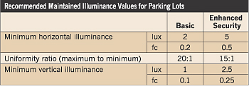

Light levels. The guide's illuminance recommendations for a parking lot are given in Table 1. These values should be measured or calculated on a clear section of pavement without any parked vehicles. While the data in Table 1 offers illuminance values, or the amount of incident light falling on a surface or object, luminance values may also be considered. Luminance is what a person sees or perceives. It's described as the light reflected off an object and the detection of that object based on adequate luminance contrast between it and its background.
Generally, tenants in an apartment building have the same security needs as a shopper at a retail mall. However, a shopping center owner may want an illuminance level even higher than what's recommended in Table 1 because of a relatively high volume of traffic or a perceived need for increased security at that location. In this case, the design should consider a driver's ability to adapt to the lower light levels of the adjacent streets after leaving the higher light level of the parking lot.
A designer should calculate the uniformity using the maximum to minimum ratio given in Table 1. In some cases you may want to consider alternate designs that either use higher wattage lamps at greater spacing or change the mounting height to reduce energy consumption or trim capital costs. Annex B offers a test grid for quickly figuring out the horizontal foot candle level on a road surface.
Vertical illumination is important in parking lots for making curbs, poles, fire hydrants, and people easily visible. Thus, one lux of vertical illuminance is recommended, and the vertical lux value at the lowest point between luminaires with the minimum horizontal illuminance should be at least one-half the minimum horizontal value given in Table 1. Preferably, it should be greater.
