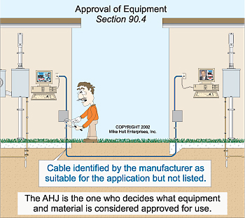

Q.
Can I use listed low-voltage or limited-energy cables outdoors or underground?
A.
The NEC requires low-voltage and limited-energy wiring within buildings to be listed as resistant to the spread of fire (725.71, 760.31, 760.71, 770.49, 800.49, and 820.49). Because the NEC doesn't require low-voltage or limited-energy wiring used outdoors or underground to be listed, UL doesn't have a standard to list cables for these applications. Therefore, you can use any low-voltage or limited-energy wiring outdoors or underground that's approved by the AHJ (90.4 and 110.2) (Figure).
