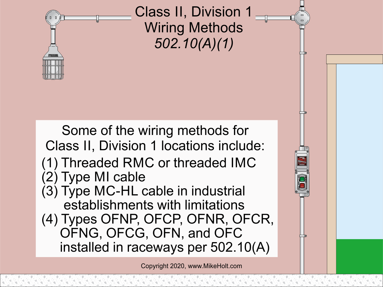

Q. What wiring methods are acceptable to the NEC in Class II, Division 1 locations?
See answer below.
A. The following wiring methods can be installed in a Class II, Division 1 location [Sec. 502.10 (A)]: (Figure)
(1) General.
(1) Threaded rigid metal conduit (Type RMC) or threaded intermediate metal conduit (Type IMC).
(2) Type MI cable terminated with fittings that are listed for the location.
(3) In industrial establishments with restricted public access where only qualified persons will service the installation, MC‑HL cable listed for use in Class II, Division 1 locations with a gas/vaportight continuous corrugated metallic sheath, an overall jacket of suitable polymeric material, a separate equipment grounding conductor(s) sized in accordance with Sec. 250.122, based on the rating of the overcurrent protective device, and terminated with fittings that are listed for the location.
(4) Types OFNP, OFCP, OFNR, OFCR, OFNG, OFCG, OFN, and OFC optical fiber cable can be installed in raceways [Sec. 502.10(A)] and must be sealed in accordance with Sec. 502.15.
