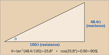

    As the amount of inductance in an AC circuit increases, so will the amount by which the current lags the voltage. The amount of lag is measured in electrical degrees. The cosine of the number of degrees of lag is called the power factor (PF) of the circuit. A purely resistive circuit has no lag (0°). The cosine of 0° is 1, or unity. A unity PF is what you want to achieve in power circuits.
    Inductive current is 90° out-of-phase from resistive current. A right triangle, called an impedance triangle, can be formed by drawing a hypotenuse between the resistance and inductive reactive magnitudes. If the inductive reactance in a circuit is 48.4% of the resistance, trigonometry can be used to illustrate that the current will lag the voltage by 25.8°. The cosine of 25.8° is 0.90, or 90%, so the circuit has a 90% lagging PF (Figure above).
    We'll later discuss how to bring a 90% lagging PF circuit closer to unity. Good PF is important for the proper operation of a power system. When PF is too low, an electrical system can suffer from poor voltage regulation and excessive losses.
