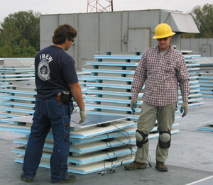

Altair not only trains electrical contractors in photovoltaics, but also provides its electrical contractors with project leads. Warmack Electric partnered with Altair two years ago to work on a $1.7 million contract to install photovoltaic systems at a KD Development 180-unit housing development in San Diego (Sidebar at left and Photo at right).

A San Diego builder and Golden, Colo.-based renewable energy systems company have partnered to bring photovoltaic technology into the mainstream. KD Development and Altair Energy are currently building the largest 180-unit photovoltaic development in the United States. Warmack Electric, an Anaheim, Calif.-based electrical contracting firm, is installing a total of 210kW on six apartment buildings and a community clubhouse to provide about 80% of the tenants' electricity needs. Richard Eidlin of Altair says these new housing developments are becoming popular in states like California and Arizona, where builders are starting to offer photovoltaics as a standard feature.
