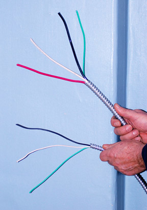

Most fundamental from the point of view of safety and functionality is the distinction between grounded and ungrounded conductors. Grounding conductors (which are ideally at the same potential as grounded conductors but serve a different purpose) are color coded differently so that they can be connected properly (Photo 1 on page C20).
For equipment-grounding conductors, the color coding is somewhat different. The equipment-grounding conductor, unless separately derived, originates in the service equipment where it is connected to the neutral by means of the main bonding jumper. From there, it accompanies the other conductors to every outlet, never to rejoin the grounded conductor. Even an ungrounded system must have an equipment-grounding conductor.
Grounding conductors may be bare, covered, or insulated. If they are insulated, they must be green or green with one or more yellow stripes. They may not be re-identified for use as grounded or ungrounded conductors.
