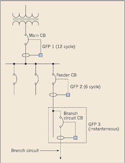

As per Code requirements, all 3-phase, 4-wire circuits, where the neutral is distributed and used for the load(s), must be solidly grounded. As a matter of habit, many designers and installers also solidly ground 3-phase, 3-wire systems. In such systems, the ground-fault sensing relays, which are installed at various levels throughout the distribution network, are time-current coordinated.
Where there are multiple levels (i.e., zones) in the power system, there is a need for coordination of the zones so that, whenever possible, the higher levels are unaffected by downstream faults. The branch circuits are like tree branches, and all of the relays will “see” the fault current in a particular branch when the fault is downstream.
Typically, you achieve coordination by setting protective relay time-delays progressively higher, with upstream relays set to maximum delays so as to prevent nuisance tripping of the breaker. However, should a fault develop at a high level and require the time delay to expire before clearing the fault, this set-up can cause unnecessary damage to downstream equipment.
This design approach raises the cost of the overall system due to the large number of ground-fault sensing relays required. It also brings about longer relay operating times due to the increased time delay settings associated with the time coordination of the multiple protective devices on the system. The source relay has the longest delay in order to prevent the main relay from tripping first.
Fig. 1 shows a time-coordinated system of ground-fault relays in a low-voltage distribution arrangement. Its relay scheme operates as follows:
  • GFP-1 responds after a time delay of 12 cycles to any ground fault that hasn’t been cleared by GFP-2 or GFP-3.
  • GFP-2 responds after a delay of 6 cycles to any fault that hasn’t been cleared by GFP-3.
  • GFP-3 responds instantaneously to any fault on the branch circuit it protects.
