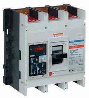

All major manufacturers of overcurrent protective devices offer ZSI-capable equipment. Photo courtesy of Eaton Corp.
