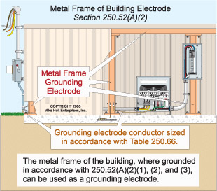

If structural steel is used as a grounding electrode for the electrical service, is it also necessary to supplement the steel electrode with an additional electrode such as a ground rod?
All questions and answers are based on the 2005 NEC.
Q. If structural steel is used as a grounding electrode for the electrical service, is it also necessary to supplement the steel electrode with an additional electrode such as a ground rod?
A. Structural metal is only an electrode when it meets one of the following [250.52(A)(2)]:
(a) 10 feet or more of a single structural metal member is in direct contact with the earth or encased in concrete that is in direct contact with the earth.
(b) As shown in the Figure, the structural metal is bonded to an electrode as defined in 250.52(A)(1), (3), or (4).
(c) The structural metal is bonded to two ground rods if the ground resistance of a single ground rod exceeds 25 ohms [250.52(A)(5) and 250.56].
(d) Other means approved by the authority having jurisdiction (AHJ).
It is unlikely that your structural metal meets (a), so it is only an electrode if it's bonded to another electrode, such as a concrete-encased electrode.
