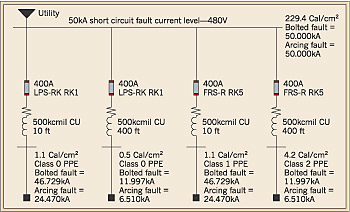

Low utility fault current levels and/or long circuit lengths can have a severe effect on incident energy levels. For example, Fig. 1 shows 400A RK1 and RK5 fuses protecting 10-foot and 400-foot feeders. This sample system has a fault current level of 50,000A. The high fault current levels make this system sufficiently robust to trip the RK1 fuse quickly, regardless of circuit length. As such, the resultant hazard levels in this example are relatively low.
So what happens when the fault current level is found to be lower? As shown in Fig. 2 on page C18, a reduced fault current level of 15,000A is sufficient to quickly trip the device that protects the 10-foot feeder. However, the 400-foot feeder creates even lower fault current levels and longer trip times, elevating the arc-flash hazard to a Category 3 designation. It's also worth noting that RK5 fuses have longer trip times than RK1 fuses, which raises incident energy and hazard levels to higher values as compared to the RK1 fuse.
Fig. 3 on page C18 shows the overall relationship between fault current levels for RK1 and RK5 type devices and incident energy levels. As the fault current in the system becomes weaker the incident energy gets stronger. This relationship holds true for other fuse types and breakers. As a rule of thumb, arcing currents that are greater than 10 times the rating of the device will trip within 1 cycle or less. Since arcing faults are typically about half the bolted fault current values, the fault current levels at each overcurrent device need to be more than 20 to 30 times the rating of the protective device to trip instantaneously.
For example, a 1,000A protective device will need to be installed in an electrical system with a bolted fault current level of 20,000A to 30,000A or more to trip within 1 cycle. A 400A device will require an 8,000A to 12,000A fault current level to trip as quickly. Fault currents lower than these factors will delay the opening of the device and cause the incident energy values to rise.
