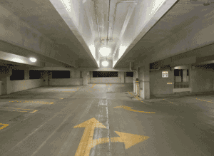

The 451 existing metal-halide luminaires in the garage consumed 232W each. Power draw of the new LED luminaire is 90W, saving more than 140W per luminaire. A cost analysis showed a simple payback on incremental cost of 1.22 years, while the 10-year IRR, cash basis, was 84.5%.
The PS14 LED luminaire uses Cree XP-G Series white light LEDs, featuring a 6000K cool white light and 73.4 CRI. The electronic LED driver from Thomas Research Products is a universal voltage (100V to 277V) Class 2 constant-current output device, featuring a 100,000-hour rated life. High-power factor correc¬tion (>0.95) maximizes power utilization. With built-in over-voltage, over-current, over-temperature, and short circuit protection, the driver will automatically recover, so that the luminaire does not require the power to be cycled to clear a fault.
The selected luminaire design allowed a direct one-for-one replacement of all existing luminaires. No circuits needed to be updated. Using the existing trunion mounting hardware further reduced the initial material and labor costs. Steve Simon, owner of Public Electric Construction, Inc., was the contractor on the project. He noted that removing each previous luminaire and installing the new one took less than 18 minutes.
